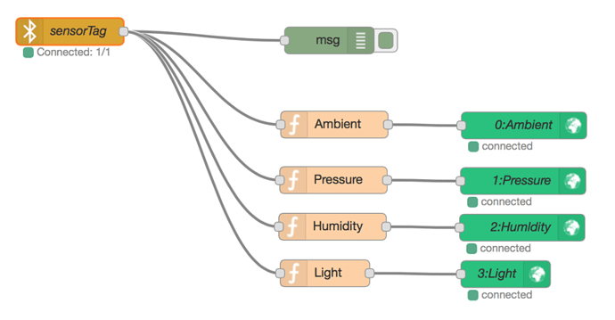

The first tests with a Raspberry Pi Zero ($5) + RedBear IoT pHAT ($13) + Node-RED were hectic, but eventually succeeded.
It’s actually not too hard to make raspberry pi collect sensortag data via bluetooth and sent to the blynk cloud using our Node.js library.
I’m going to give Blynk for Node-Red a try!
No major issue with the node-red-contrib-blynk-websockets, except it still uses a non-secure connection (ws instead of wss).
