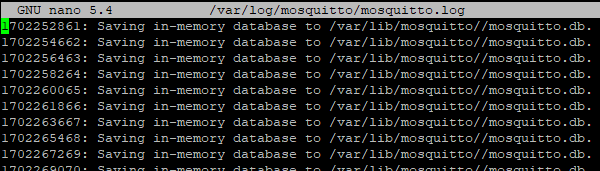

I don’t know as well how to clearup the log file, but opening it results in only lines like following:
For this I typed: sudo nano /var/log/mosquitto/mosquitto.log
as this path is in the Mosquitto.conf file:

You can use the Nano editor to cut (CTRL-K) the text then write-out the edited file (CTRL-O) or you can simply delete the file and allow it to be recreated when you re-start Mosquitto
for that you’d use these three command to stop, remove (rm) the file and restart…
sudo service mosquitto stop
sudo rm /var/log/mosquitto/mosquitto.log
sudo service mosquitto start
