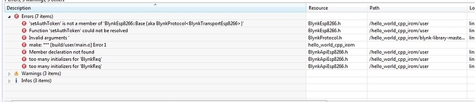

Hello! Now I’ve tried to compile project that you gave in Eclipse and I get some errors that I can’t resolve.
I think this is a types inconsistency, caused different version of code in /user folder and /blynk-library-master.
Here is a project itself.https://dl.dropboxusercontent.com/u/92887381/blynk/esp8266.zip
