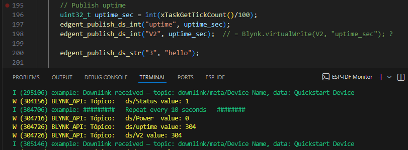

Hello everyone, I’m having trouble with the Blynk.virtualWrite(VirtualPIN, “value”); function in ESP-IDF 5.5.2. I’m trying to send data from the hardware using the edgent_publish_ds_int(“V2”, uptime_sec); function, but without success. Isn’t it the same as the Blynk.virtualWrite(V2, “uptime_sec”) function in Arduino? Tks… Gladimir.
