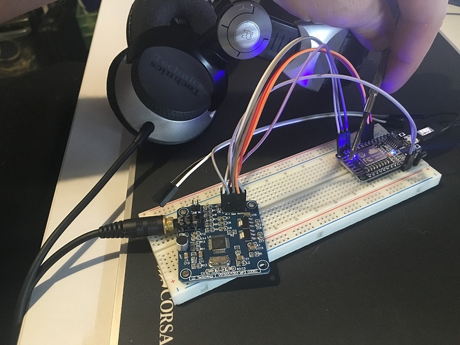

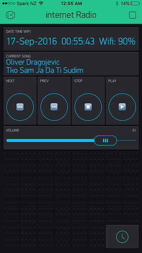

Here is a shot of the basic app layout and functions and also a shot of the setup.
It’s just an esp8266 dev board and vs1003/1053 MP3 codec decoder. I found some code online and just trying to reverse engineer it for Blynk.

Hi there!
How do you get the measurement about WiFi signal strength?
Thanks!
map(WiFi.RSSI(), -105, -40, 0, 100) + String('%')

Dear @Jamin Jamin,
thanks a lot for your fast reply.
Sorry I didn’t understand what your command
is doing ex where the WiFi level percentage is fetched … I am not programmer tho
Best Regards,
Mike Kranidis
WiFi.RSSi() gets the WiFi signal strength in dBm and then the range of -105dBm to -40dBm is mapped to a % between 0 and 100.

@Jamin you connect the screw drive to ESP-12F antenna is that to get better WIFI signal ? :slight_smile:
Absolutly correct :wink: … haha jokes… the blue led was making my camera go nuts so had to cover it lol!
