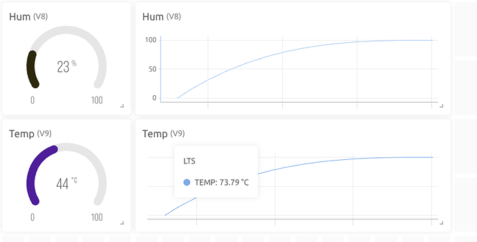

Full sketch is uploaded now. I find it strange that i get correct values in serial monitor, but the values in here is completely off:

I might be missing something in here:

The screenshot shows the edit mode , not the live mode :thinking:

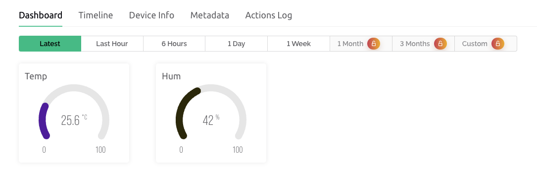

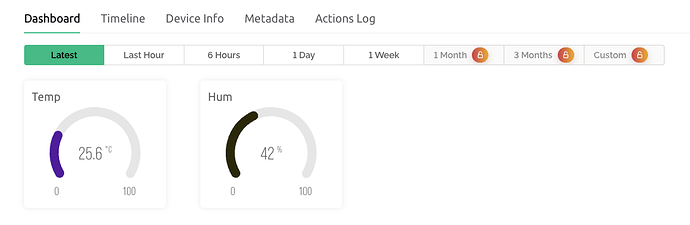

Now it seems good :+1:
Thanks for help and inputs Pete and Blynk
From your screen shot it appears your are looking at the TEMPLATE page in the browser. You should be looking at the DEVICE dashboard page.
billd
that’s what i said, problem solved :joy:
