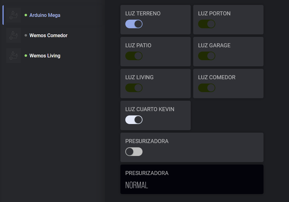

Hi all! How is the method to use BLYNK at home? since now having multiple devices makes it difficult to use both the app and the web. I have 2 Arduino Mega and 2 Wemos in my house.
The first option I did was to make a template for each one. It worked for me, but every time I needed to do something in another room, I had to leave the template I was in and go to another.

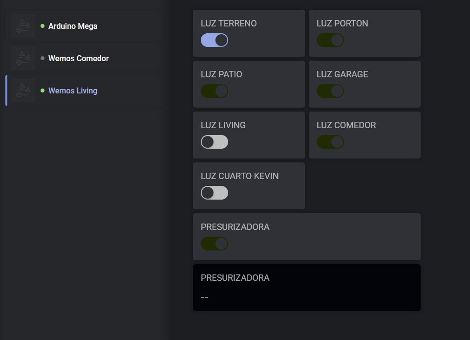

Then the option I made today was to make 1 single template with all the devices but now what happens to me is that I have ALL THE BUTTONS in All the places and for them to work I have to change the device yes or yes, for example:
Arduino Mega.
1 switch = Living Light.
Wemos
1 Switch = Garage Light
In both devices, all the switches appear but one does not work in the other, that is, if I want to turn on the light in the living room and turn off the light in the garage, I have to exchange devices / templates to be able to do it.
It got a bit tedious, I used to use bridge before, it was a good solution but now blynk was thought more for the “industry” and stopped being an application / service to domotize your home.
Pics:
i use BLYNK for my house not for commercial.
