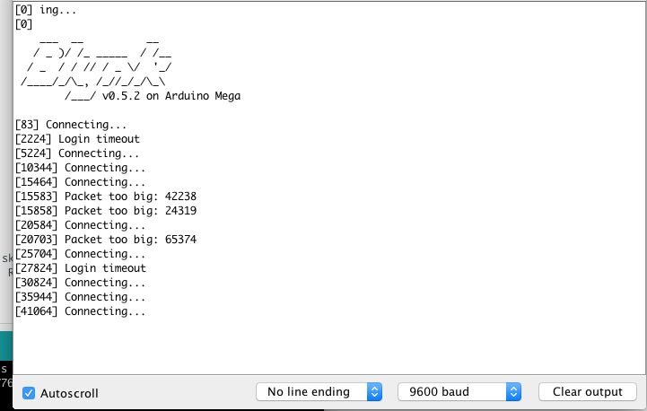

also if i open the terminal of the arduino this is what i see
thank you

That just means the BT module and your phone are connected… not that the UNO and the Blynk Server are connected.
Confirm you have the correct TX to RX and vice versa pin connections and BAUD rate between your UNO and the BT module.
Google for complete direction on how to do that if necessary as it is NOT Blynk specific.
