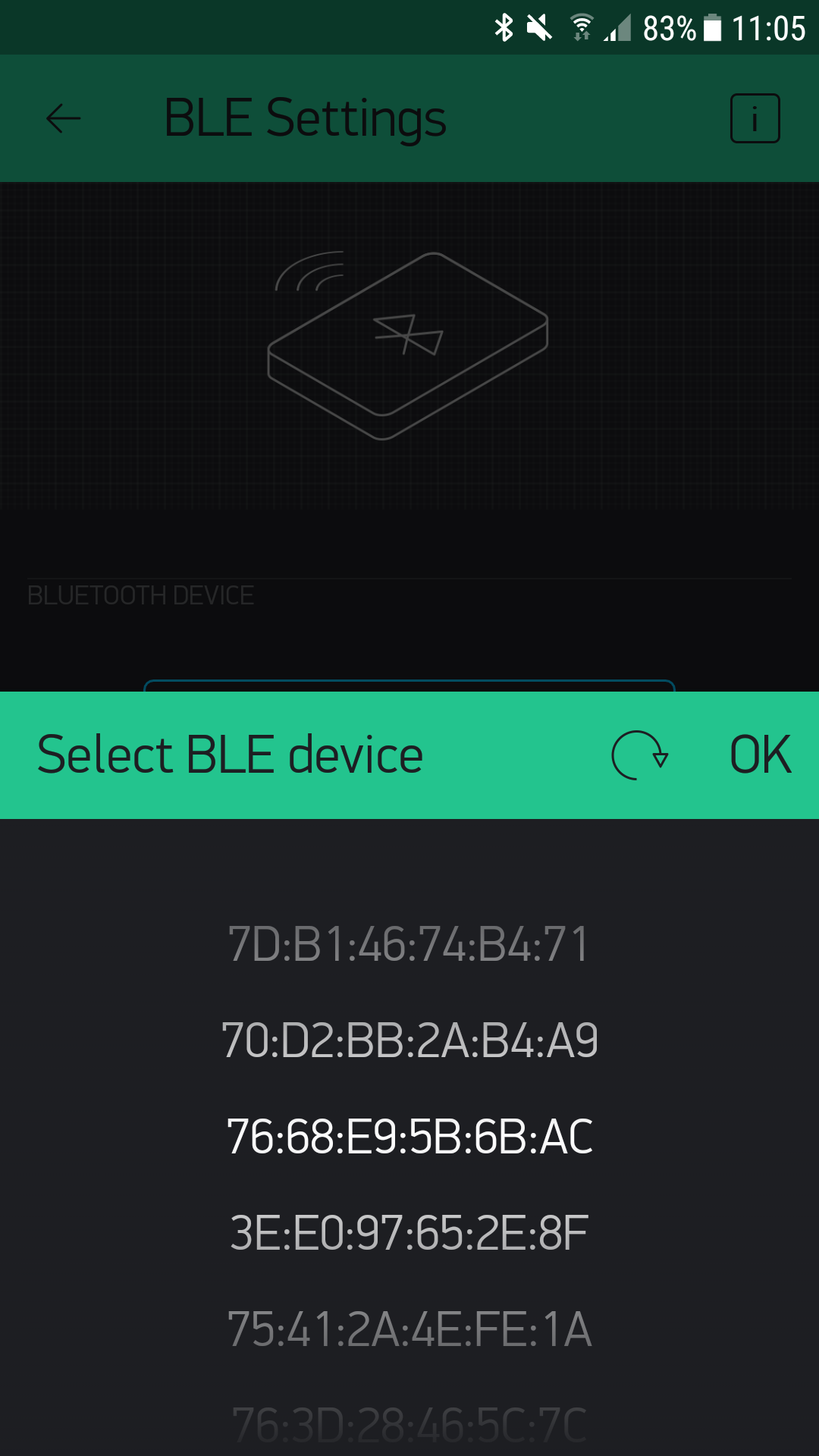

I am setting up Arduino 101 with Blynk (via BLE), using a Samsung Galaxy S7. I tried to find and connect my BLE device through the Blynk app, however !the options were unreadable. On my Arduino IDE, I set my device name to be “Blynk”. Please refer to the code and screenshot below. What is the root cause of this problem?

Yep, we saw such issues on our devices in some cases too - getName method for BluetoothDevice on Android returns null, so we decided to show a mac address in such case.
Usually, after a successful connect to that device Android OS somehow gets the needed name, but not always - it differs due to Android’s version or hardware, sometimes it’s just the first scan for the devices returns no name, but on the second one - it’s ok.
I’ve searched for some resolutions of this issue and found one possible way to fix it (but still I do not think it will work in 100% of cases). I could implement it and send a logging build to verify would it help or not.
I’ve added several possible updates for getting device/local name.
You could check them in the apk by the next link, to install it you probably will need to uninstall your current one.
