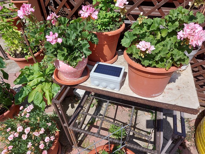

First and foremost i apologize for any mistakes in my english. I am trying to make a solar weather station using a NodeMCU board, a DHT22 sensor and the Blynk app. After uploading the code, everything seems to work just fine, for an hour or such. After that, the app seems to freeze and unless i restart the board it stays like that (sometimes not even the restart works). I have tried to increase the time between my dht22 sensor readings to half an hour, as i suspected that too often readings my cause the freeze, but just as i said, in a matter of hours, it became unusable. Below you have my code and a picture of the app.
Please feel free to butcher it as any advice is helpful. Thank you in advance.

Ok. So, for the moment, i have changed the port (int Sensor_PIN = D0;) and changed the update interval at 60 seconds. I have tested the functionality of the device and it works ok, both on solar energy and 5v power supply. I only have one more question for you guys. I heard that Li-Ion batteries, while subjected to heat (my “device” is basically a plastic box in the sun, with little holes for sensing the humidity) tend to… catch fire. Should i be concerned about this aspect?
The batteries will almost certainly distort as a result of the heat. If you’ve gone for the flat battery packs then this often leads to them bulging and failing.
It also depends what over-charge regulation circuitry you’ve used.
