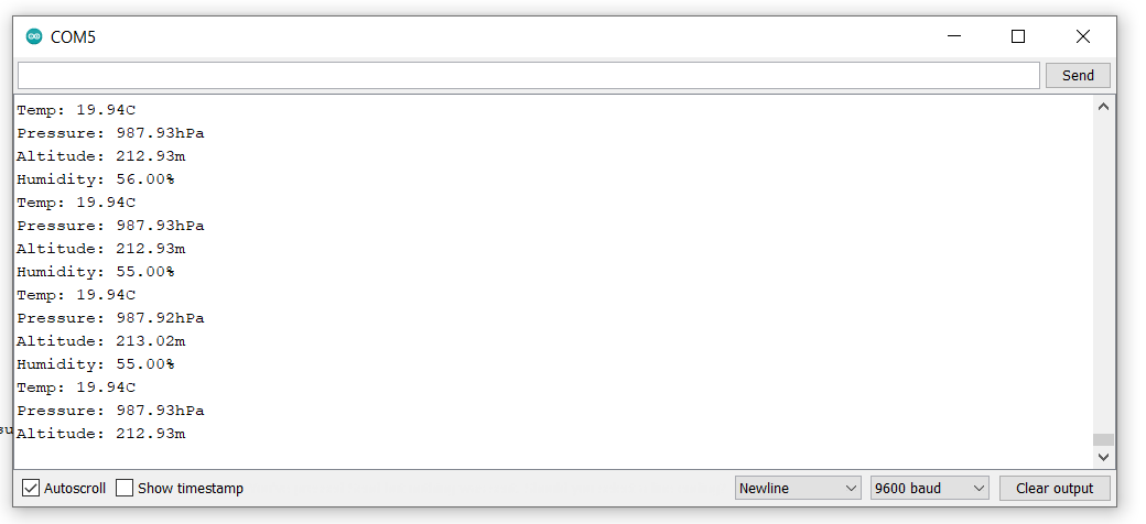

SERIAL MONITOR :
I don’t know what happened but somehow i got data on the app!

The serial monitor output really needs to be the part when the device boots/awakes as this will show the Blynk connection attempts and useful debug data. As I said earlier, serial monitor output really needs to be copied and pasted between triple backticks rather than posting screenshots.
Clicking the ‘Show timestamp’ checkbox in the serial monitor would also be useful, as it’s impossible to tell from the screenshot if the device is actually going into deep sleep or not.
As you’ve not mentioned any connection between GPIO16 and the RST pin and there is no Blynk connection attempts showing between temperature readings then I assume that the device isn’t actually going into deep sleep mode at all.
My advice, based on the limited information is…
- add a
delay(1000); after the deep sleep command to allow the deep sleep to begin
- add a
Blynk.run command immediately before the deep sleep command, possibly with a short delay after it, to ensure that the Blynk.virtualWrite commands are processed before the device sleeps.
- ensure that you have a connection between GPIO16 (Pin D0) and GND to allow the device to wake after sleeping
- remove the second
Serial.begin(9600); command from your void setup, and change the first one to a baud rate of 74880 so that you see the D1 Mini’s system messages in a useable format when the device boots/wakes.
