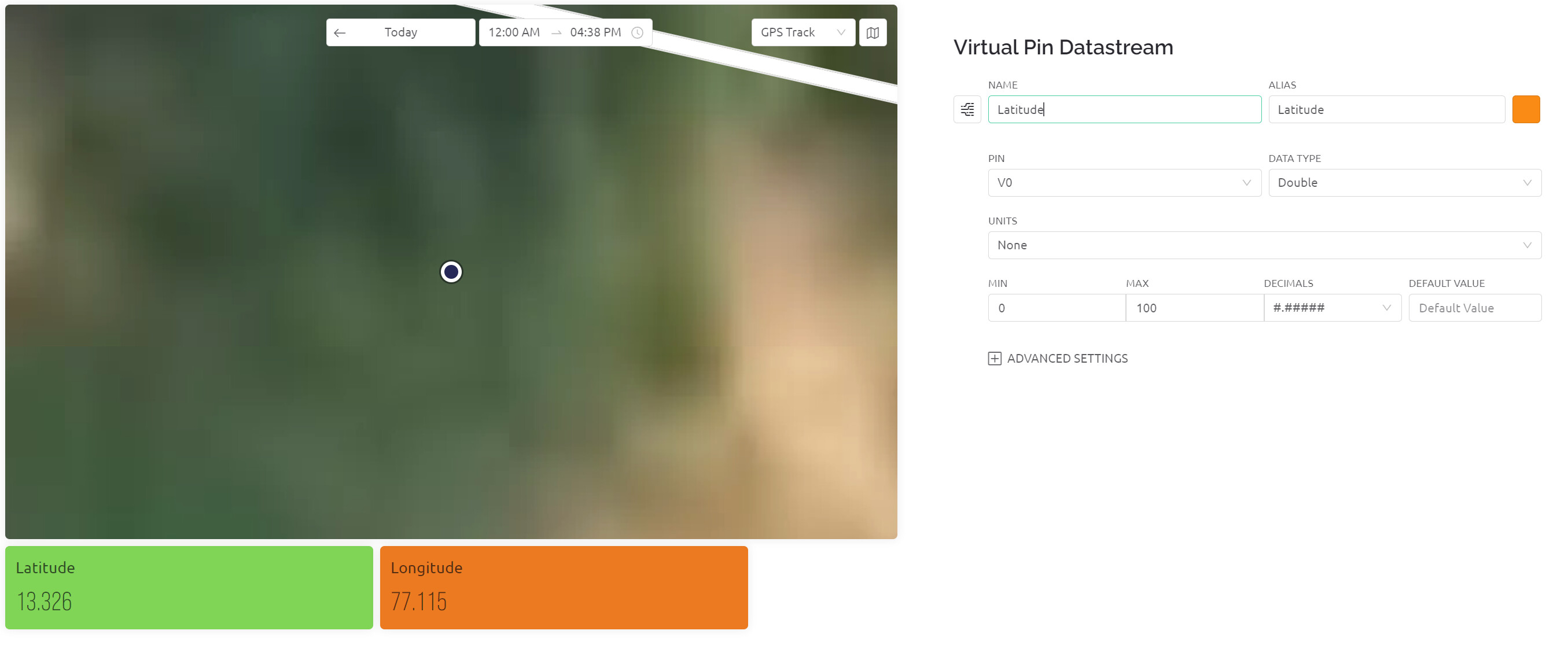

I’m not able to see more than 3 decimal places on the web console nor the app. I have made the settings of virtual pin to display 5 decimal places. Need help.

Decimal latitude and longitude values range from -180 to +180 so defining a datastream with a minimum value of 0 and a maximum of 100 makes no sense.
Is there a reason why you aren’t using a Location type datastream for this?
Also, you’ve not really shared enough of your sketch because we can’t see the data types that you’ve declared for your Lat and Lon variables and your code shows you writing these values to V1 and V6 but your screenshot shows the setup for datastream V0

V0 for Latitude to display in Value Widget
V1 for Longitude to display in Value Widget
V6 for Location Datastream to display in Map Widget

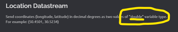

So, if you are using a Location datastream type for V6, rather than the Virtual Pin datastream type of the datastream you used in your screenshot then you’ll notice that it says this…
but instead you are using float variable types…

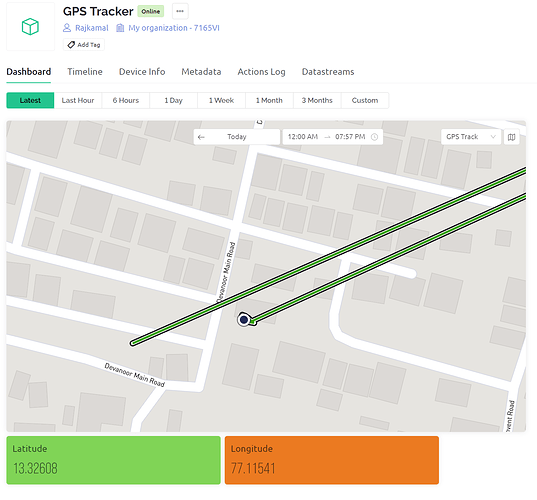

Thanks a lot for all you inputs, I’m able to display 5 decimals on the web console.
I Chaged float to double and I’m rewriting the the time function using Blynk Timer.
Can I display more than 5 decimal places on the new blynk?

the max option I have in the web console is 0.##### five decimals. what if I use string instead of double?
So youre talking about V0 and V1 now, not V6?
Yes, you cold pre-format the data into the desired string and send it as a value to V0 and V1 if you change the datastreams.
I solved the timer issue. Can you let me know how to get more than six decimals on the web console?
Even 5 decimal places is an accuracy of 1 meter, in reality the GPS system cannot provide such accuracy
