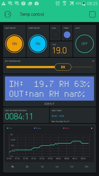

  2. On my dashboard there is no place for that (would have to use Tabs, which I don’t want in this case):
