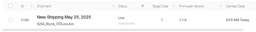

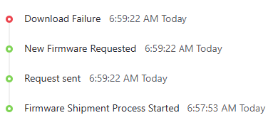

Hi Pete, Thanks for your previous recent help for this newbie. I used your sketch. I had an initial headache that ESP8266Ping.h didn’t show up in the library manager of IDE 2.3.5 but I got passed that by finding it on github and installed it locally. (I deleted that post when I figured that out.) Anyway it work! Well it worked the first time. In setup I have it Serial.println("Setup Complete Version: " + String(BLYNK_FIRMWARE_VERSION)); and of course it did it with the original when I initially uploaded it to my 8266. And then the first time I shipped an update with the incremented version number it worked! From Version 1.1.4 to 1.1.5. However it only worked once. Every time since then I get I get a “live” status and it never gets to finished.
This is what is printed on the serial port. It looks like it’s connected but nothing is downloaded. I’m not sure why it worked the first time but no longer. What have I missed?
05:57:53.471 → Setup Complete Version: 1.1.5
05:57:53.504 →
05:57:53.585 → OTA Started
05:57:53.585 → overTheAirURL = http://ny3.blynk.cloud/static/fw_6523757209194219855_-838595071.bin?token=lMw7St4f-Axhe-hIpuBqSsRZEV-0kNBY
05:57:53.787 → httpCode = 200
05:57:53.787 → contentLength = 309808
05:57:53.787 → canBegin = 1
Difficult to say, because I have no idea if you’ve changed anything other than the version number. Did you change any compiler settings?
As I said before, the ping stuff isn’t needed. It’s simply the ESP8266 version of the HTTP update stuff that’s needed, and the slightly different syntax for the code in BLYNK_WRITE(InternalPinOTA).
What happens if you you do a USB flash, then try to re-do the OTA shipment that worked last time?
It may help if you started a new topic, instead of cluttering up this one.
