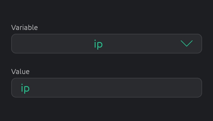

go back to blynk app and choose a placeholder then choose the name of the variable you would like to store in that placeholder.
for example, choose placeholder 1 then use the text input widget and enter ip, like this
after that you will notice that the menu item placeholder 1 has been changed to ip
Which indicates that the placeholder 1 is holding the ip variable, now after clicking the get button, the ip Will be sent to datastream V7
