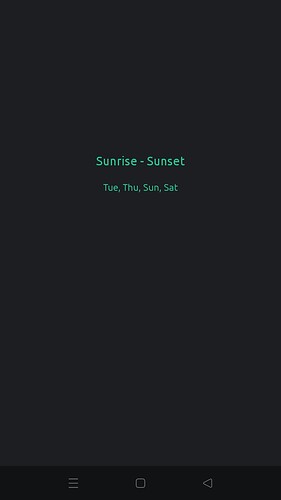

Thank you for the prompt response to rectifying this issue. I also confirm that the sunset/sunrise option is again active in the app. The days of the week are also recovered and are operative again.
