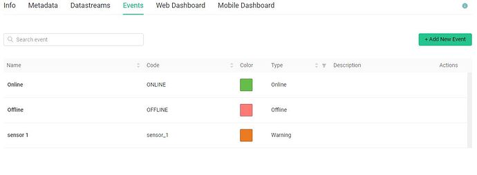

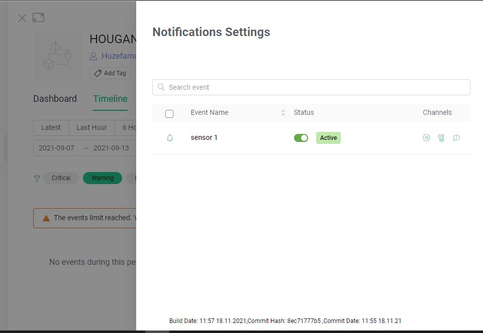

Are events appearing in your timeline?

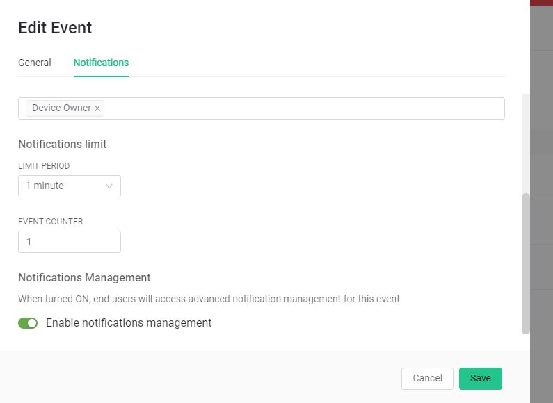

If so, how have you configured the notifications for your device in the web console?

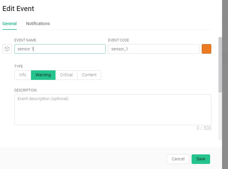

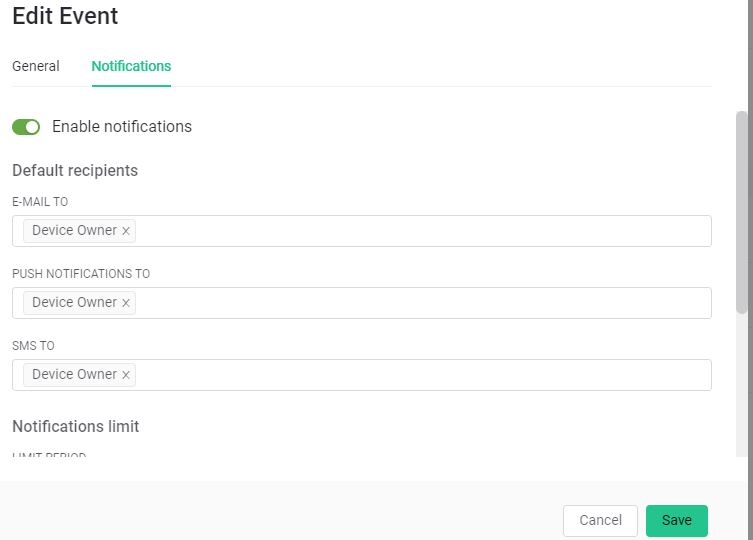

Dear sir thanks for reply sir
i attached here all the screenshots how i configure the notification please take a look if i do any mistake let me know sir thank you sir
i hope you hear me soon
Best Regards
Maaz

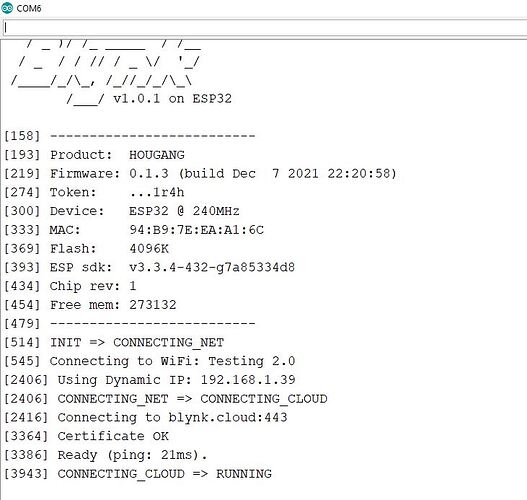

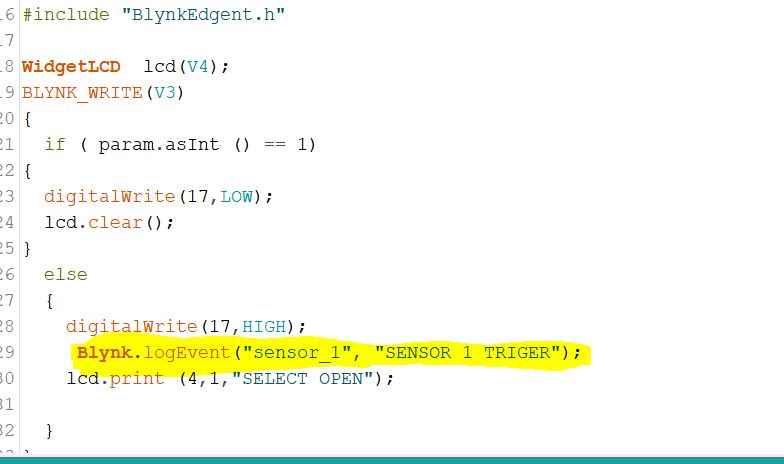

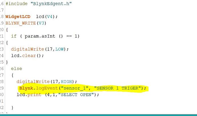

Is your event actually being triggered in your sketch?
What do you see in your serial monitor?

Dear sir
can receive seriel data when trigger the alarm
but i still cant receive the notification
seriel

Please stop posting screenshots of your code and serial monitor. Copy/Paste them instead and use triple backticks.
Are you saying that you’ve amended your code to add a serial print command when the logEvent command is issued?
Dear sir
Yes sir I use serial monitor to check

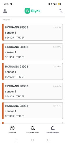

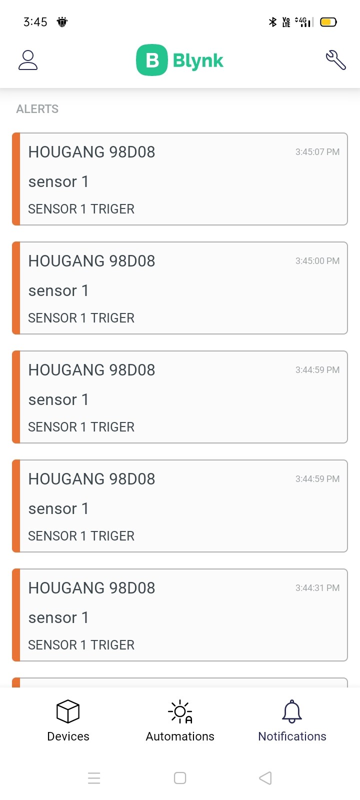

My notification received thanks
Best Regards
Maaz
