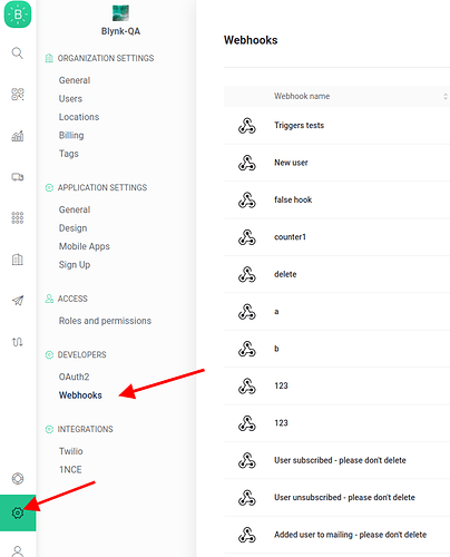

Could you give some additional info, please. Do you see the “UPGRADE” button after creating of 1 webhook?
I don’t understand the “new webhook” button just appeared :thinking:
Thank you !
2021-12-03_194731
Ok, nice, probably you have checked it before latest deploy. Enjoy!
