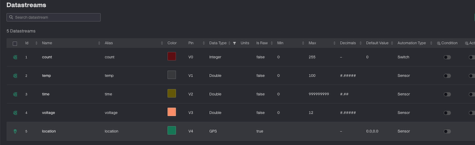

Yes, it’s a Location datastream type, named location. Config attached. Still not working.

Here is my Blynk Template datastreams configuration:
