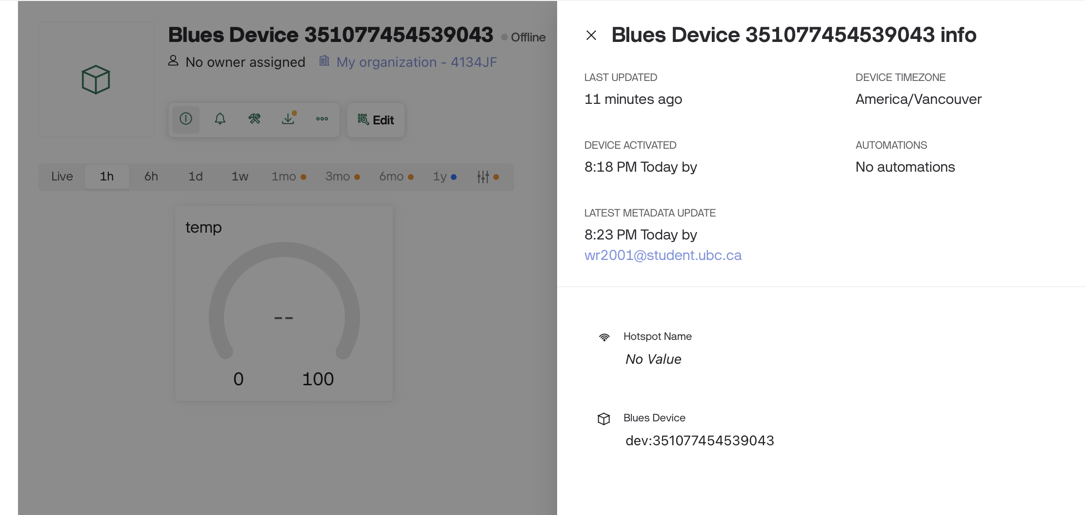

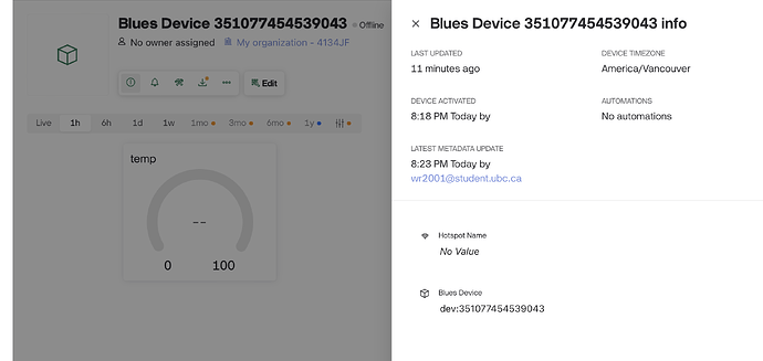

On the Blynk end, the device says that is not connected and the data stream I have for doubles under the same name of “temp” does not appear to receive data. However my messages used keeps incrementing when I try to send the data so it is reaching Blynk, as well the time of “Latest Metadata Update” for the device updates when I send data as shown below

Please, make sure your JSONata keys (in your case temp) strictly match with datastream name.
Also, since you are using JSONata, you have to manually wrap your data with body object, so that your result JSON should look like this:
  "body": {
    "temp": 25.2
