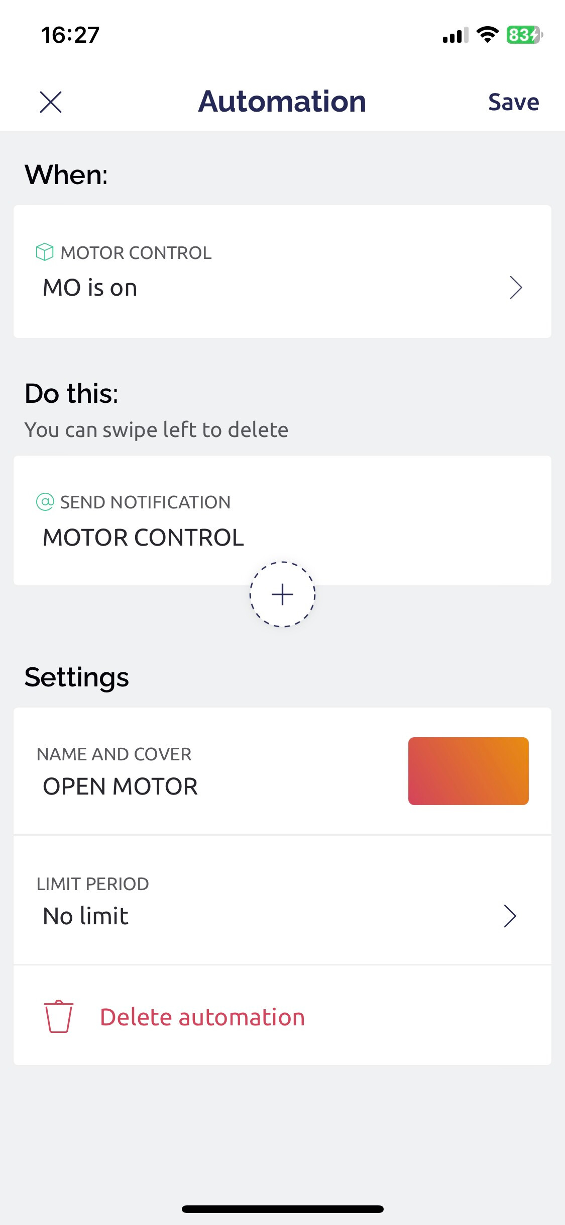

I add an Automations - Look like images
But some time it’s popup Notification - Some time it is not!
Is it a problem? Can every body tell me know! Thank you so much!

Hello. There is a limit. 20 emails/pushes per device per 1 hour in automations.
