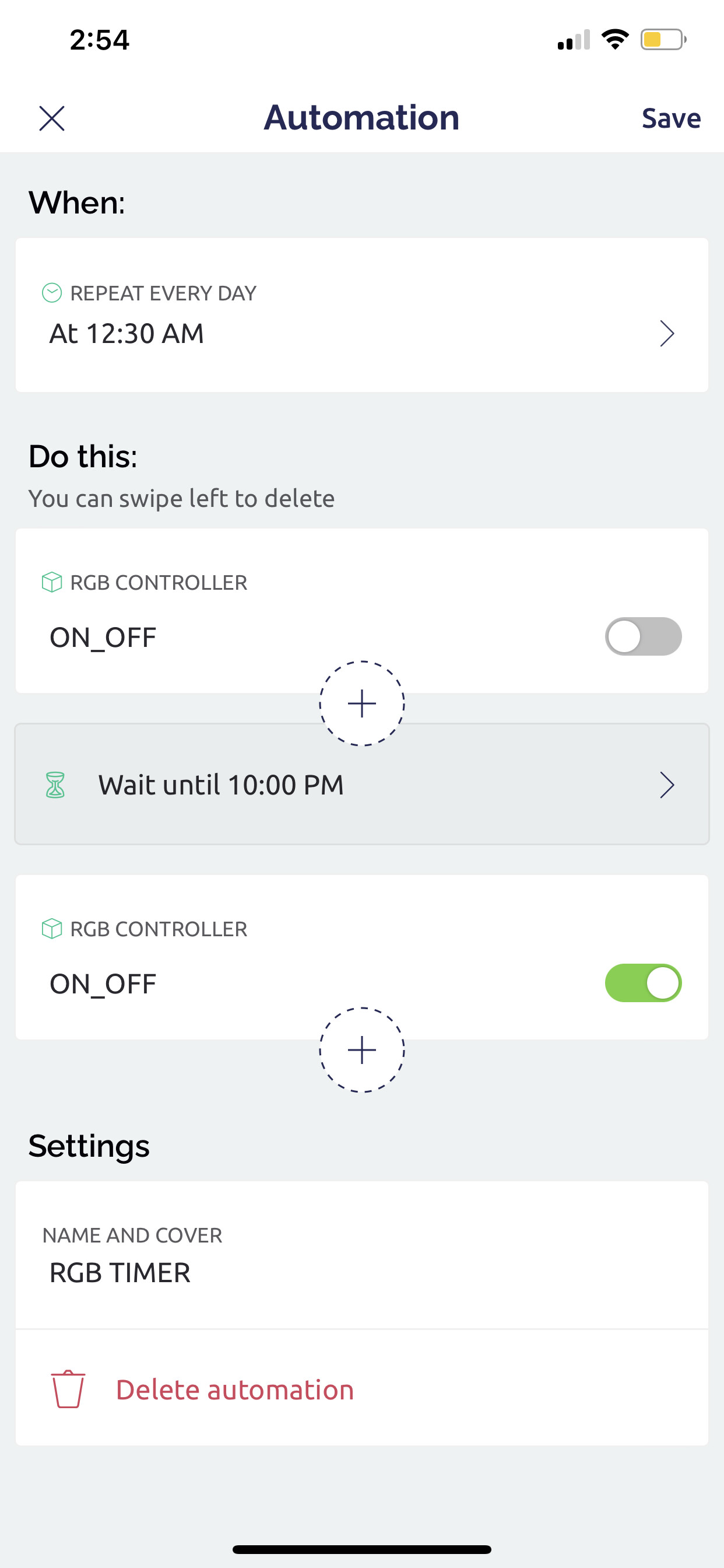

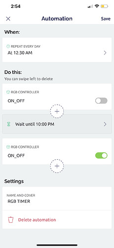

I have an automation setup for my RGB strip.
It turns on at 10 and turns off at 12.30
While wait till is being executed, you cannot turn off the automation or control the device. There will be a animated loading icon displayed.
If you have virtual pin defined in the code and a button is attached then you can turn it off.
But here the concept of code less automation is not fulfilled.
There must be a over ride button to stop automation at any point of time.
