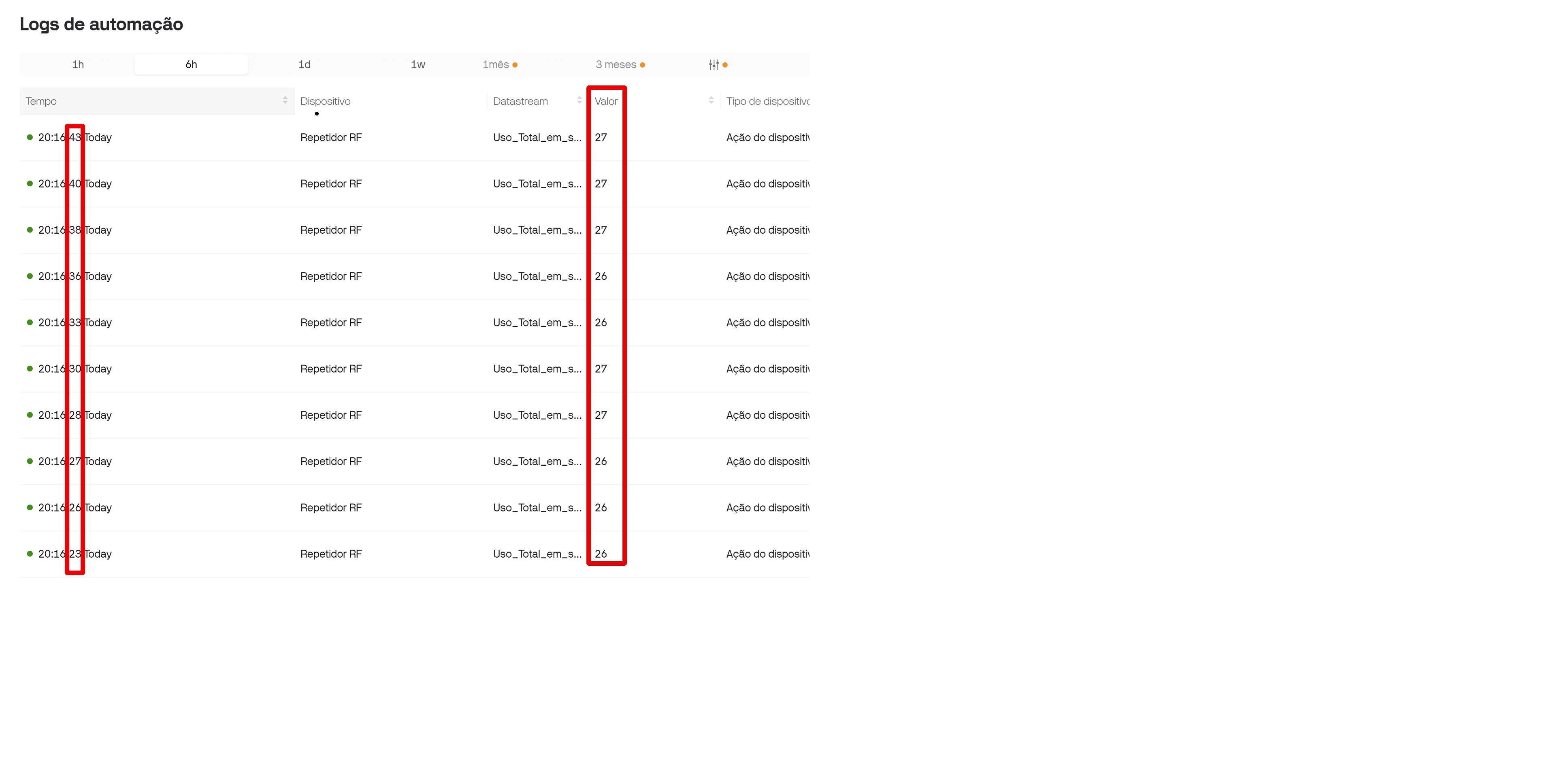

After configuring Automation using both (Web Dashboard and Mobile app), it was supposed to keep both ends Sender (V6) and Receiving (V8) with the same value. But mostly, it doesn’t happens as expected due to a known issue: Sometimes i have 2 changes in Temperature in less than 1 second. When it happens, Automation is unable to send the most recent data value, as can be seen in print below taken from Automation Report.
If we take a close look to the 2 highlighted red squares, we can see that Automation sends the same Temperature in a row, when it was supposed to send the most recent one. It keeps this way until there is a new change in Temperature and, eventually, loses sync again due to 2 changes inside the same second.

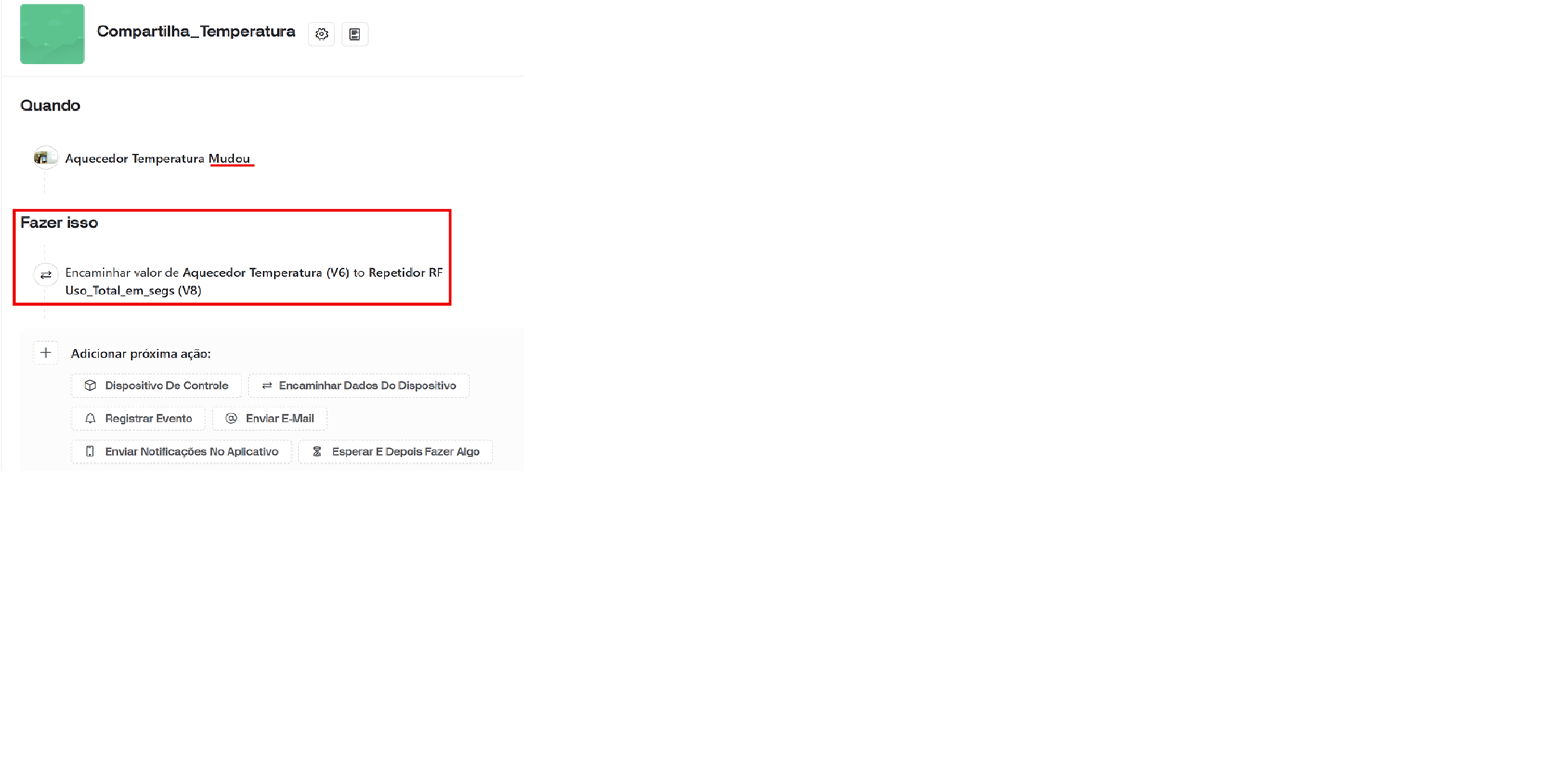

Below, Print taken from Automation configuration in Brazilian Portuguese.

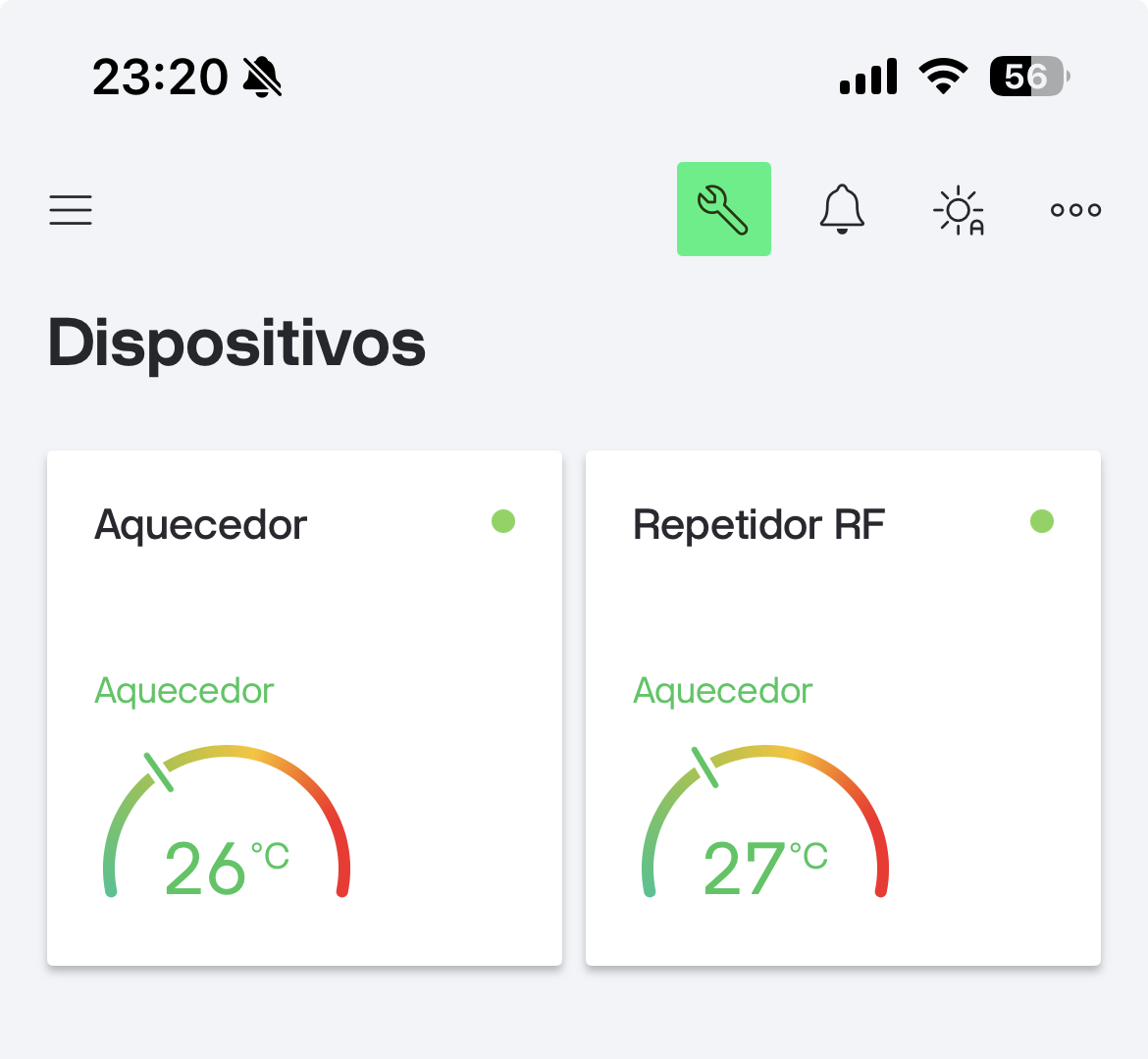

And the print from Mobile App where Temperature is not the same.
Important note: I’m aware that Mobile app Tile shows both device’s V6, but Receiving Sketch takes V8 (BLYNK.WRITE V8) and then send it back using Blynk.virtualWrite V6.
