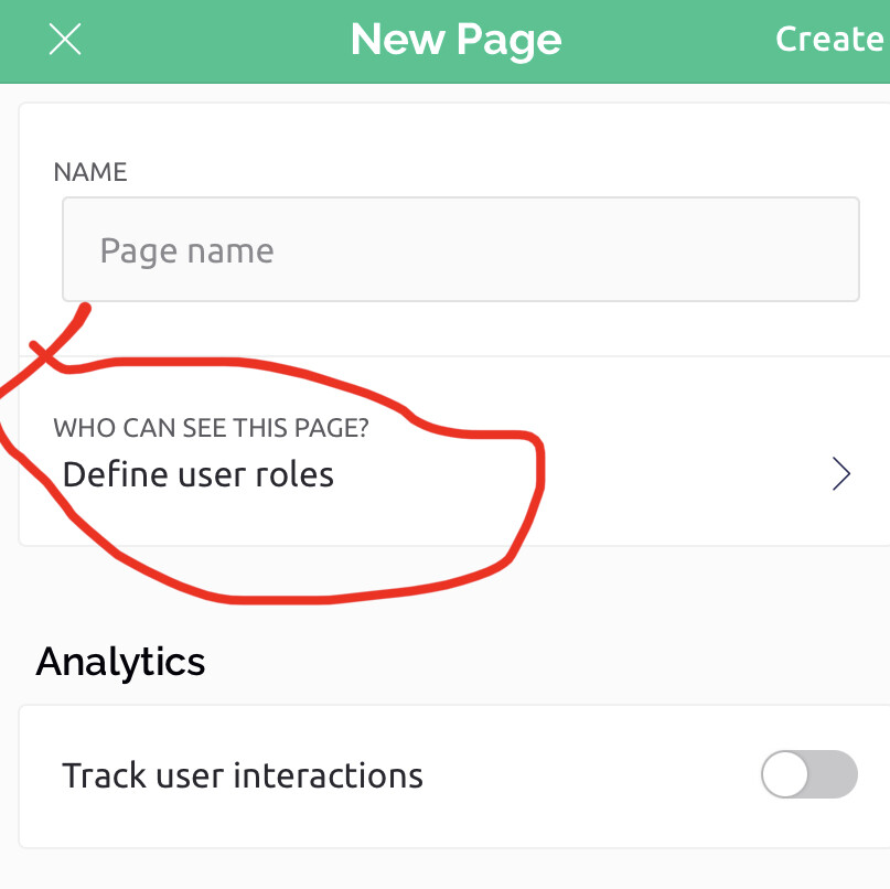

I have this option…
But I maybe that’s only available with a Pro subscription?
Must be why then, I have the Plus subscription :neutral_face:
Ian
Hi Lan,
You need to select “device info tab” settings, this function is only there.
