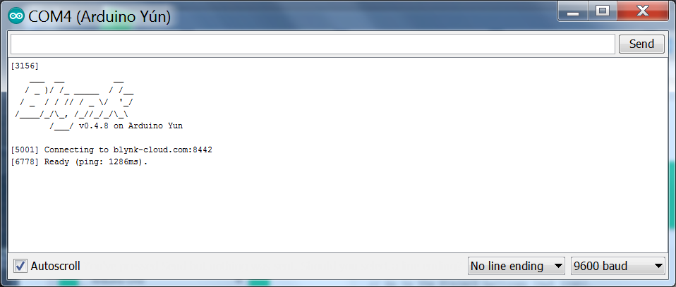

I have tried the Yun example with the WIFI connection, copied in my Auth token and uploaded the sketch. In the monitor I get
Does this mean it is connected? It hasn’t provided the IP address as in your example.

I believe your screenshot does show a proper connection… at least between the Yun and the Cloud Server… however that ping time is dreadfully slow and would be the cause of many issues.

The slow ping time is probably because I am using an ancient (in computer terms) USB modem in the TP-Link router, compounded by the WIFI connection which will be slower than an ethernet connection. For our work it isn’t imperative to have the fastest connection, more interested in the lowest power draw possible so our solar backed batteries have longevity.
