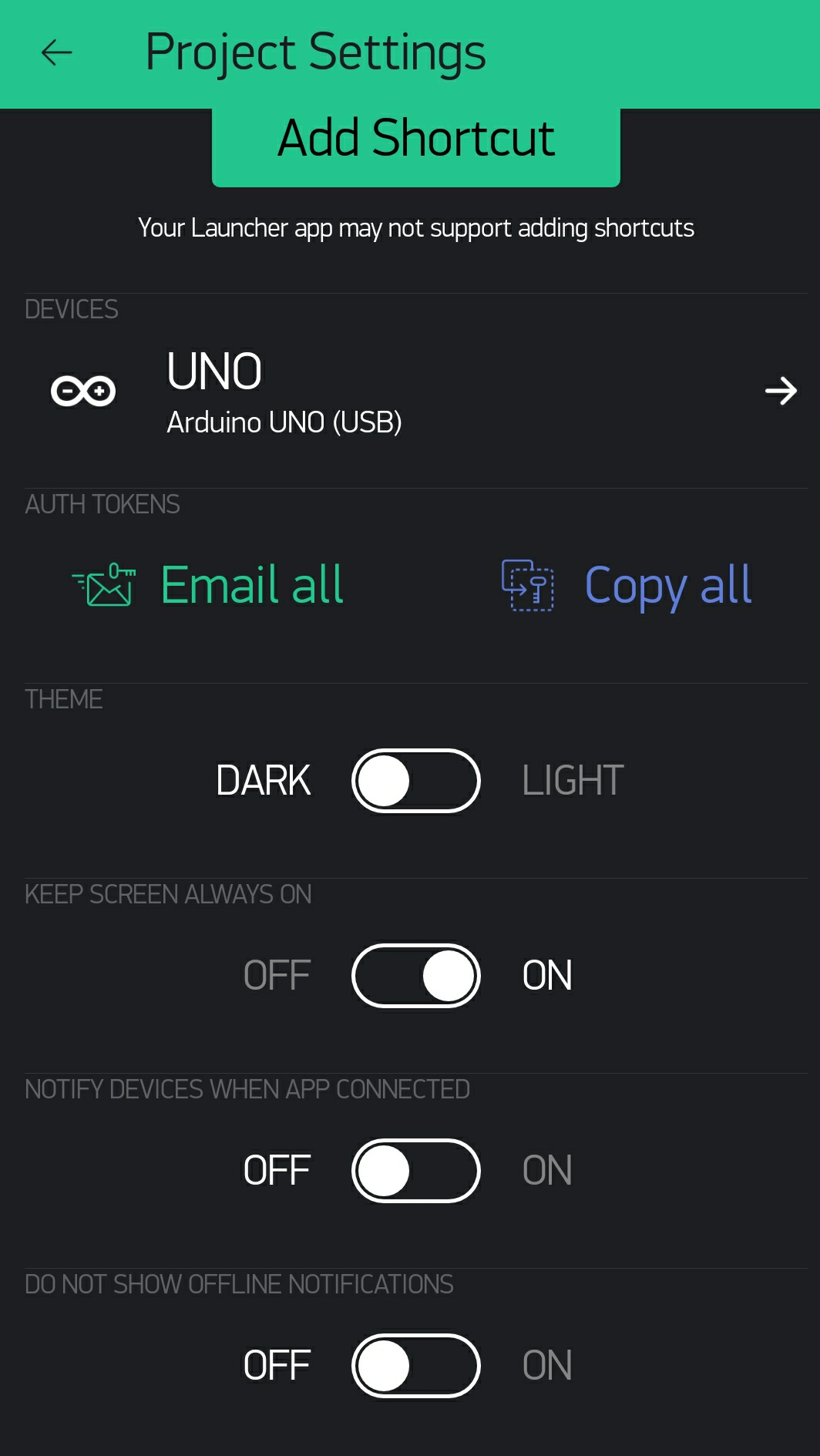

First, I used my Arduino Yun to connect Blynk and all things was ok. Since a MFRC522 module was used and I found Arduino Yun cannot dirve this RFID module, which goes well with Arduino UNO. Then I chose UNO instead of Yun. However, I don’t have other shield and USB is the only choice.
I just use the example program for test as the example video shows, but the device is showed “offline” in the app.

but it is still offline… the blynk-ser. bat keeps running and the IDE is closed
it the setting right?

I have changed the Auth code and the device is still offline
the serial monitor is not open.
Change your code to this (with new AUTH)… if the device connects to the server the onboard LED will flash rapidly (4 times a second), if disconnected, it will go OFF (in about 10+ seconds).
