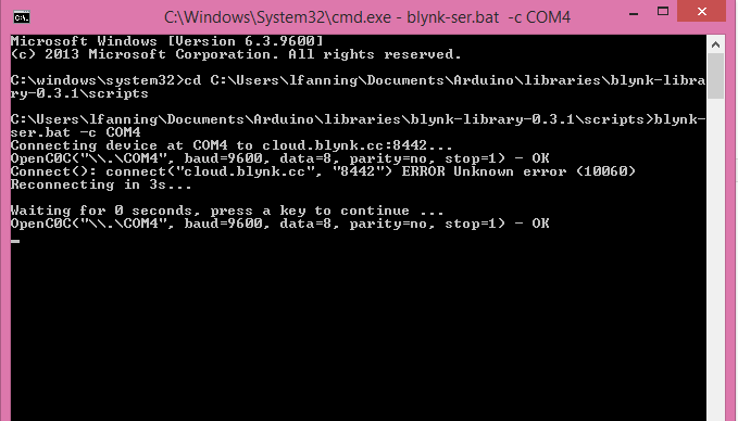

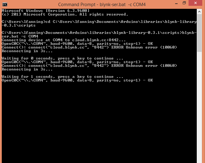

This is what I keep getting when i try to run “blynk-ser.bat -c COM4” in cmd.exe do you know what this means?

Despite what I said, 10060 error often relates to firewall issues. So try disabling for a test.
Is that the only way to fix it because I dont have access on my computer to disable firewall
If you don’t have access to the firewall then maybe your ‘administrator’ is blocking access to some ports.
Do you use any proxies?
As per my earlier post the only firewall reference I have ever seen relates to the Arduino IDE itself and I have never had to disable the firewall or open any specific ports to access Blynk via USB.
Do you remember being asked about firewall access when you installed the Arduino IDE?
The hardware just wants to connect to cloud.blynk.cc on a non-default port. Because of that in the majority of cases it will be blocked by a firewall.
