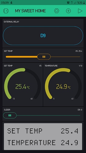

hi @PeteKnight ,
i rearrenged my code between backtick
the boiler will work until it rises 2 degrees above the set temperature.
wont work 2 degrees under above the set temperature
Mr @PeteKnight hi,
What can i do for my this project, please help me.
I want to be run in my home…
