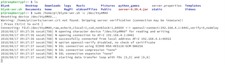

I am using a local server on a raspberry Pi Zero W (headerless and stand alone with connection via wifi ssh) which is linked to an Arduino Mega via USB. I can connect to the server via my mobile device (ipad or iphone) over wifi to the Pi Zero W. But I can no longer connect the Arduino to the server via the USB - I had this working for a very short period but had problems with scripts running at reboot.
I am running blynk-ser.sh and it creates a connection to the server.
Everything seems to be running properly, but the Arduino never connects to the server. It seems that the problem lies in the USB connection from the Arduino to the Pi.
Running “lsusb” through ssh on the pi shows that it is not connected.
