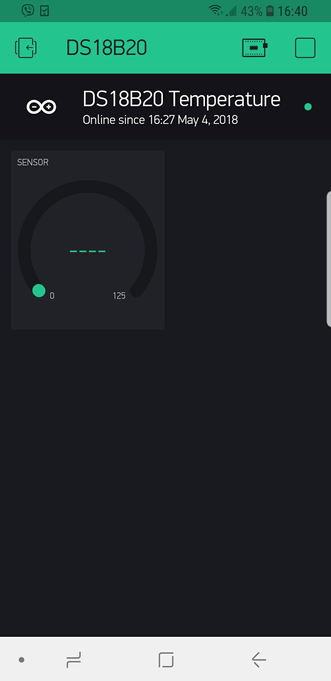

Result on phone app:
Everything seems to work, as programmed :stuck_out_tongue: !
You just forgot to set up timers, where sendTemps will be called.

Yes, because your sendTemps function, where the temperature is read and sent is never called to do the job!
Look at examples, how BlynkTimer is meant to do the timing job. Those are essentially 3 lines of additional code:
  • BlynkTimer timer;
  • timer.setInterval(1500L, sendTemps);
  • timer.run();
put those in the correct places and it should work
