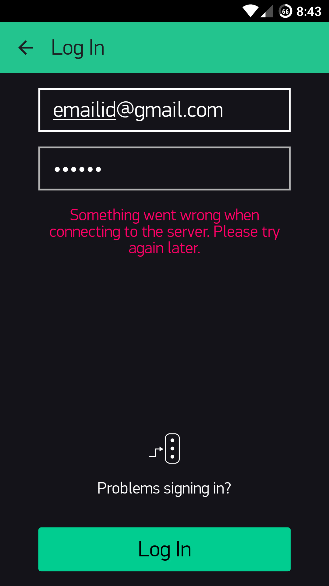

I can’t connect from my Application to blynk cloud
My hardware are connected normally but my app can’t connect.
I am in android Ver 1.13.2

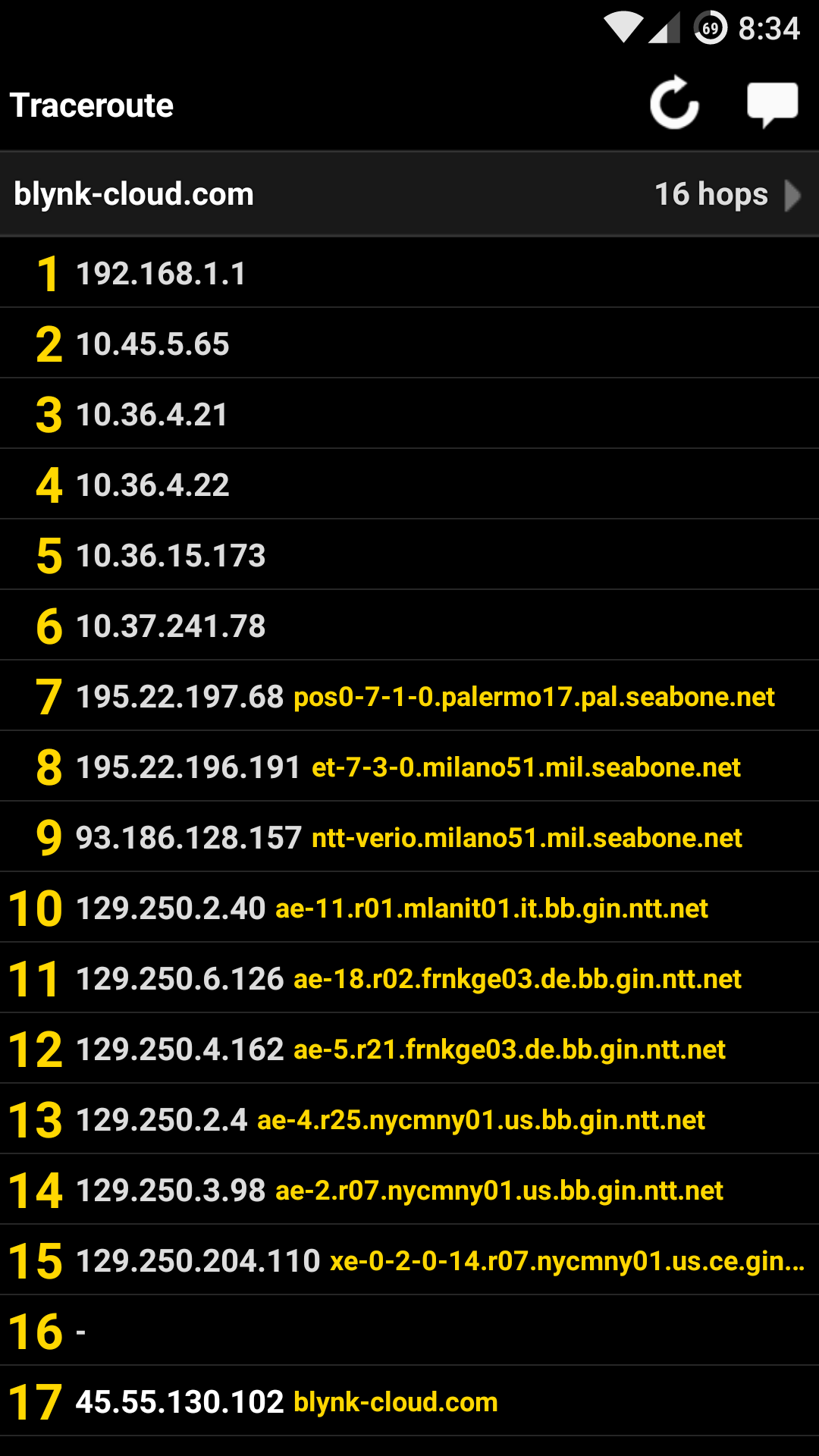

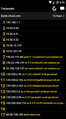

Below is the trace to Blynk cloud
And the error on my app i removed my email ID
Is it a general problem or my ISP has an issue?
We don’t know what exactly causing issue. Still investigating. could you please tell us where are you geographically?
Also is your network interface uses IPv4 or IPv6?
I am now in Egypt, and my network only have access to IPv4, my App and Hardware was normal working before in Egypt in same location and isp

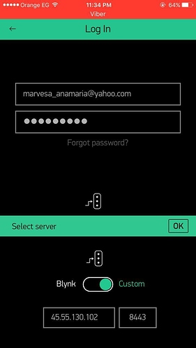

Interesting. @scropion86 could you please try connect with IP
45.55.130.102
Just to exclude possible reason.
@Dmytro the same result FAILED.
@Dmytro no not working even when connecting using IP as local server but i can access the restfull APi normally.

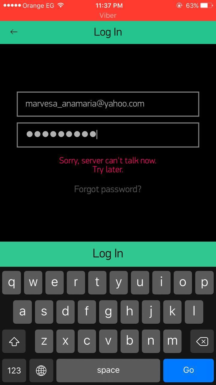

@JohnNassiem is that ios screenshots?
@scropion86 we don’t yet exactly reason. So only workaround would be local server.
@Dmytro yes , and its the same for Android :slight_smile:
