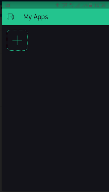

By deleting the My Apps you created from the project.
It does not work, in my applications there is no project.

Ok one last test. Try to select the project in My Apps and once it’s been created try deleting the app and see if that fixes it. You don’t need to go trough the full procedure of My Apps just the creation of an app.
I have done it with this project and I have not got it, however I have created a new project and I have performed the add and remove operation of my applications and it works perfectly
