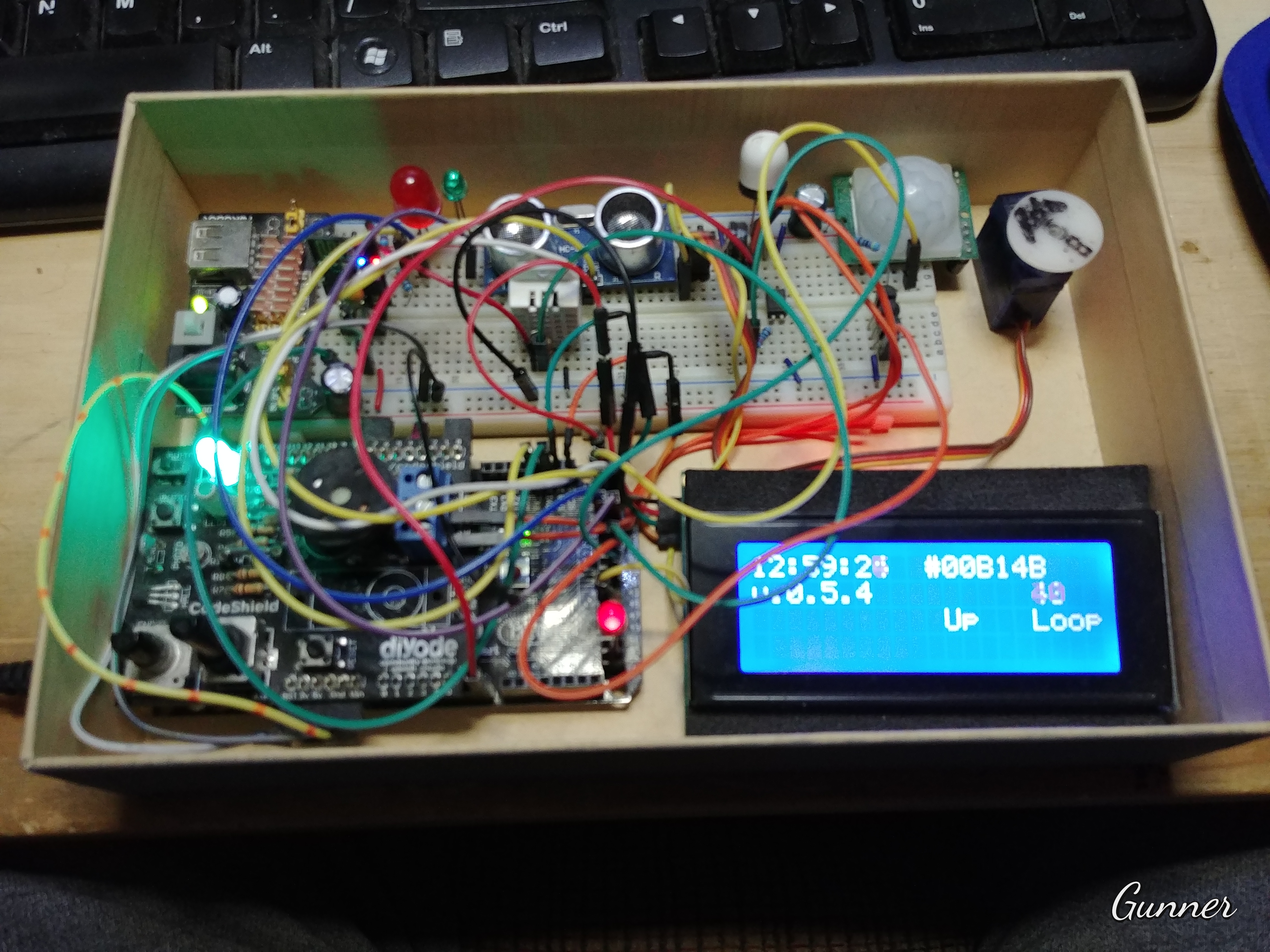

And it will never recover unless I reset the Arduino. This is the setup:
I see now… it is a hardwired physical shield board. Just pick up a ESP-01 for a buck or two and wire it up any way you want to the Mega. That’s how I do
