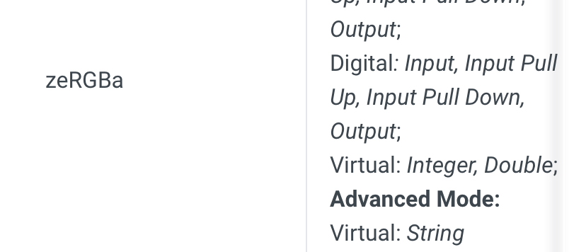

I have the Blynk application on IOS and I want to use the zergba widget. According to the documentation, you have to use a string datastream when you want to use the merge mode.
However, when I want to choose the datastream, I am only offered integers datastreams. I have looked in old posts and I saw that only the IOS version had this problem. I would like to know when this issue will be fixed. If not what are the other solutions to use the zergba wigdet with a led strip and the FastLED library.

According docs ZeRGBa widget supportes integer datastream Widgets (app) - Blynk Documentation
@Babacar is referring to Advanced (Merge) mode.
The three values should be sent from the widget as a string array, but this is a bug in the iOS app as it doesn’t allow string datastream types to be selected.

Same problem in Android. No abtility choose stings datastream.
Possibly an error in the documentation. Need to be clarified
It’s possible.
Thank you. Only in Advanced mod
Yes. In iOS “Advanced” mode is known as “Merge” and you can’t choose a string data type.
If you re-read the original post this is the error that is being described.
Reproduced in iOS. Provided information to the iOS developer.
