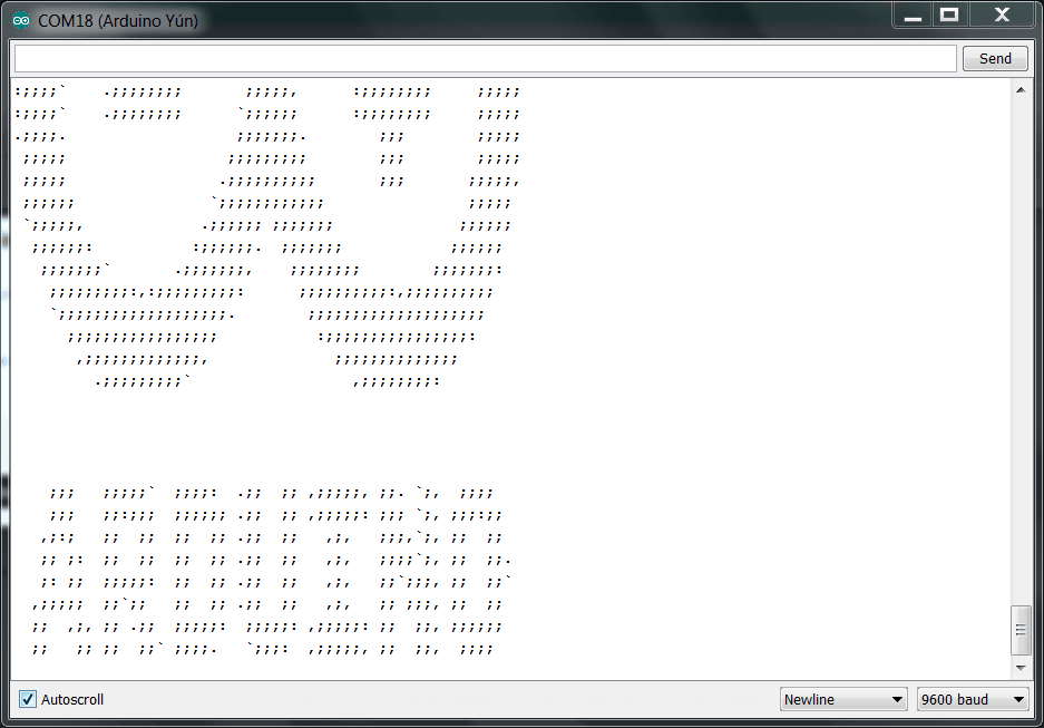

As i can not get the Yun to work with the company wifi i tried to plug in into the network with ethernet
The sketch belows works and downloads the text (“http://arduino.cc/asciilogo.txt”)

Working ethernet sketch:
#include <Bridge.h>
#include <HttpClient.h>
void setup() {
pinMode(13, OUTPUT);
digitalWrite(13, LOW);
Bridge.begin();
while(!Serial);
HttpClient client;
client.get(“http://arduino.cc/asciilogo.txt”);
while (client.available()) {
char c = client.read();
Serial.print©;
Serial.flush();
delay(5000);
