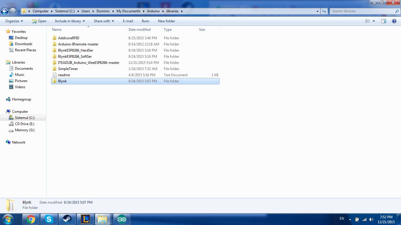

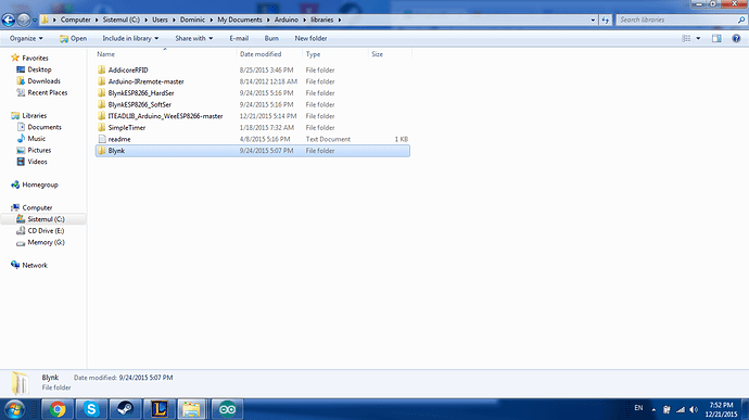

The Blynk library contains several 3rd party libraries.
You need to copy them manually to your libraries folder.
The structure should look like this:
~\Arduino\libraries\Blynk
~\Arduino\libraries\BlynkESP8266_HardSer
~\Arduino\libraries\BlynkESP8266_SoftSer
~\Arduino\libraries\SimpleTimer
Please check that you have this structure
i can`t understand what i must do. give me more information
Check that your Arduino "Libraries " folder has the same structure:
