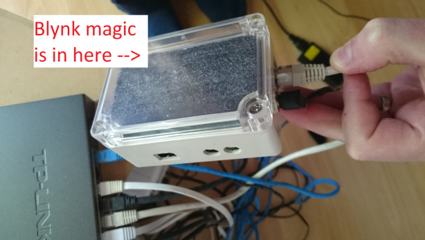

well, i am not a very technical person and rely on it being magic
but i never switch off my Raspberry Pi box - i think the magic is contained inside there…
