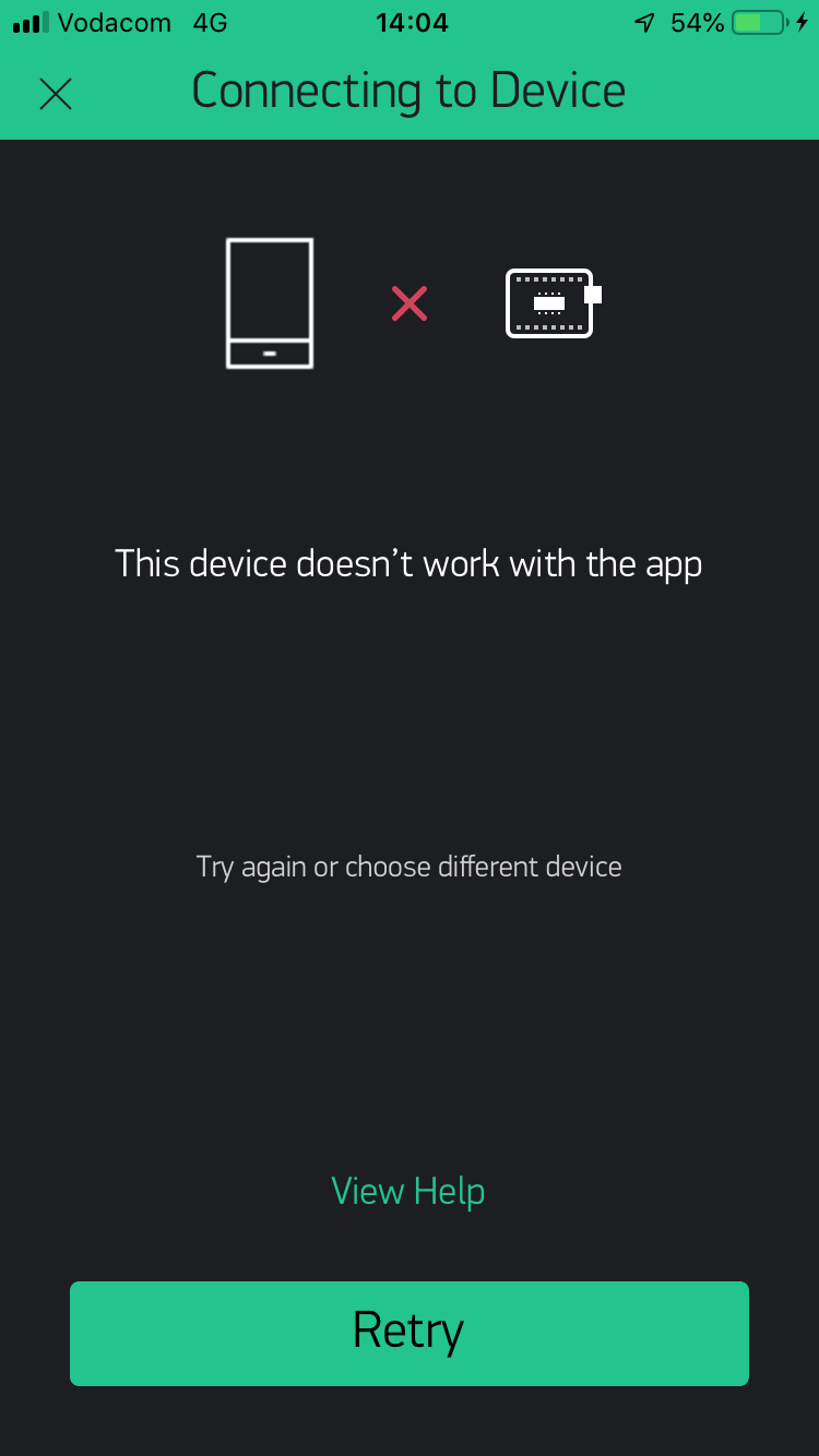

I am currently using a Wemos d1 mini for my project . I want to start using the Blynk,Inject to start using it as an app. I have uploaded the Template_ESP8266 onto my board just to start testing but every time I want to connect the board to the app it says “This device doesn’t work with the app”.

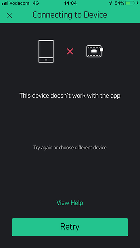

Here is the image that i receive.

I used the custom board , in the code and i used the Wemos D1 mini in my project.
I did try just the Standard template_ESP8266 that you find in the examples, but that gives me the same response.
I haven’t subscribed to a commercial plan yet , i need to test it with the preview function first to ensure that the app will work. I have followed those steps yes.
The answer/solution to this:
In Settings.h (of Blynk.Inject), there is a #define BOARD_TEMPLATE_ID “TMPL0000”
The comment to this is “// ID of the Tile Template. Can be found in Tile Template Settings”
Go to your Blynk project and make sure one of your device tile Template IDs matches whatever you have defined for BOARD_TEMPLATE_ID
Once there is a matching one in the project, this error message will not be presented and the device will dynamically provision correctly.
