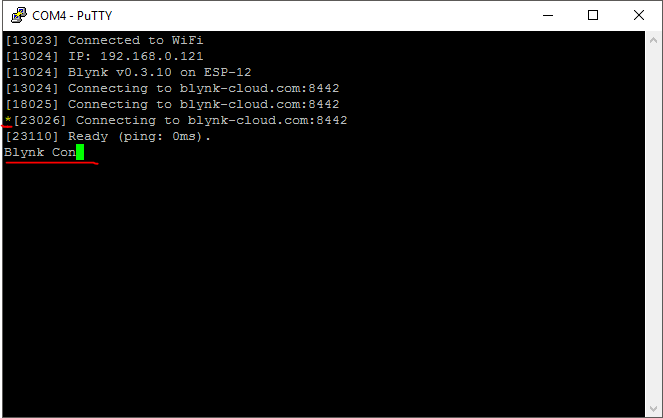

I cleaned up the code a bit and I have also included a screenshot.
  • The Poll loop for isNotConnected runs once and we see a “*”.
  • On the subsequent connection attempt we see “Ready”.
  • After that, "Blynk Connect " is printed after the Blynk.syncAll() and the terminal remains at that state.
  • Meanwhile V1 is incremented from some old non-0 value from the server as expected.
Note that the print at the end of the loop() never executes also.

Any reason you are using Putty?
I prefer putty.

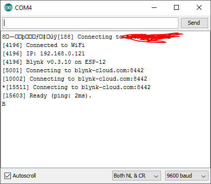

Similar behavior with Serial Monitor. It’s beginning to look like a hardware issue. Unfortunately I don’t have another serial-USB adapter to try.
Where did the dot and B come from?
Definitely try different hardware…
The “B” comes from the BLYNK_CONNECTED() callback after syncAll(). It doesn’t print the whole line. In my first screen cap it shows “Blynk Con”.
Not sure where the . comes from. Maybe from debug “Ready…” line.
