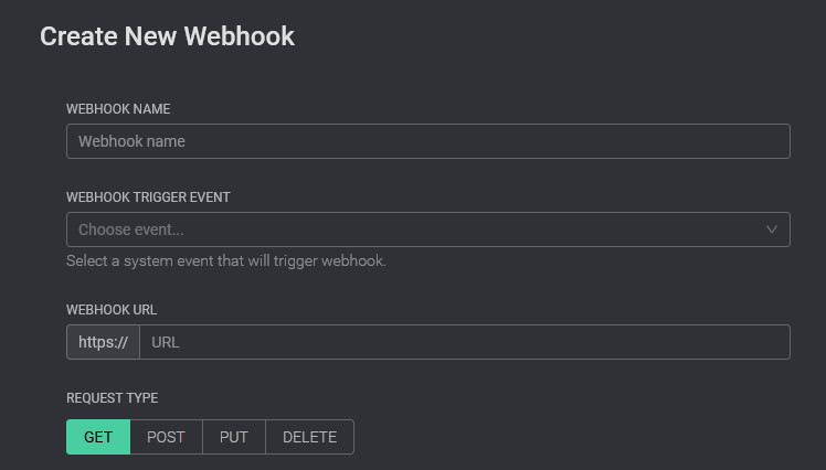

Webhooks are now should be available on the Web Console. There is a known validation issue, but it should work in general.
FREE plan - allows 1 webhook
PLUS - allows 5 wehooks
PRO - allows 10 webhooks
Limits could be changed based on further feedback.

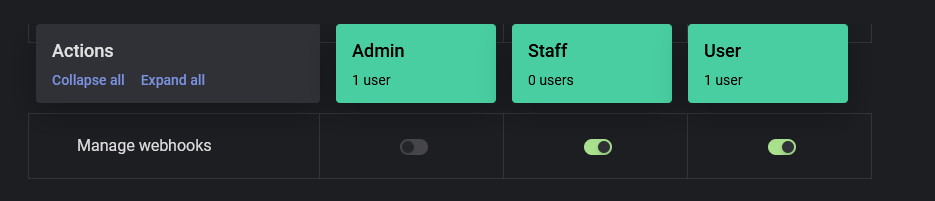

Hi @Dmytro , is this where I should find the webhook settings?
I can’t see webhook, no more developers section on the Web Console , am I wrong ?
manage webhooks is forbiden , I can’t turn on

92

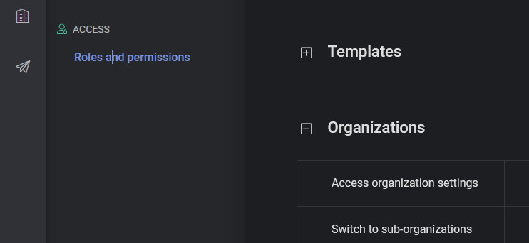

@Blynk_Coeur can you tell me where can I find it please ?
settings/roles-and-permissions/organizations

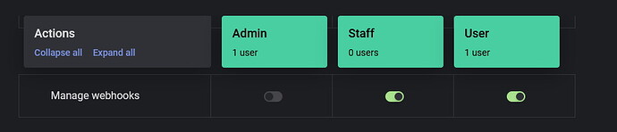

@John93 @Blynk_Coeur it’s gryed out here too. May be still under development? I tried on different browser too, no luck…
I can change Staff and user options but not admin, same for all grey options in Roles and permissions
You can change them, but you add onto be able to save them.
You are right Pete, I can’t save them.
Yes but we need to authorize only admin to be able to see webhooks
Dmytro
November 1, 2021, 9:41am
99
Sorry. Forgot to turn it on. Enabled.
