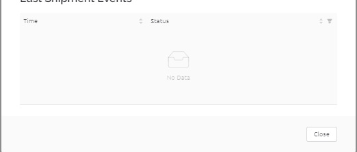

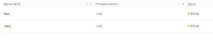

What do you see in the shipment? What statuses per device?
Both online and the events are empty
