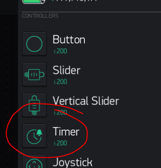

@Gunner by the way - do you use the newly created timer?
Huh? I used the only Timer Widget I am currently aware of. The one with the Start Stop option.

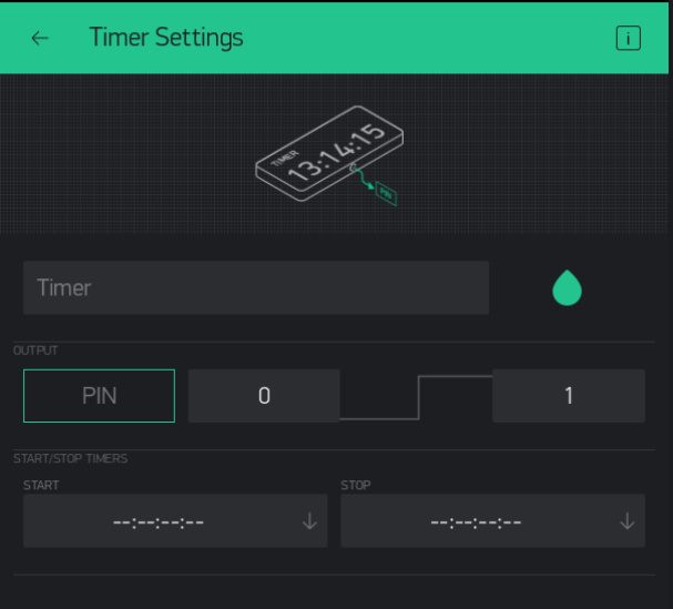

@Dmitriy I am using your server and 2.17.2 (not latest Android), added a Timer today and sync returns nothing. No tags etc just a straight Timer.
@rotarucosminleonard @Gunner @Costas thank you guys for the report. Bug is found and fixed. Was introduced due to back compatibility fix. And thus tests were wrong too :smile:. We will try to release it ASAP.
