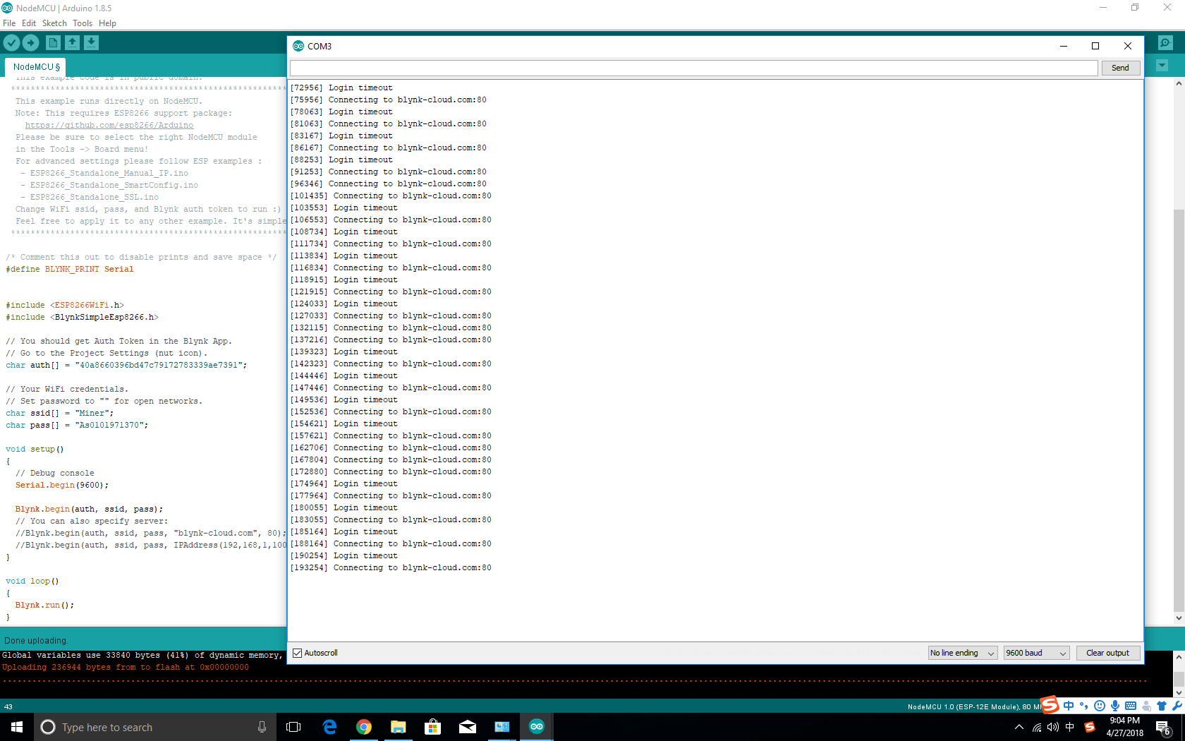

Timeout is chip offline (Can’t connect to blynk-cloud.com:80)
char auth[] = "281b222a31e249efa4a27f915ea1b70d";
char ssid[] = "Miner";
char pass[] = "As0101971370";

char auth[] = "YourAuthToken";
char ssid[] = "YourNetworkName";
char pass[] = "YourPassword";
  //Blynk.begin(auth, ssid, pass, "blynk-cloud.com", 80);

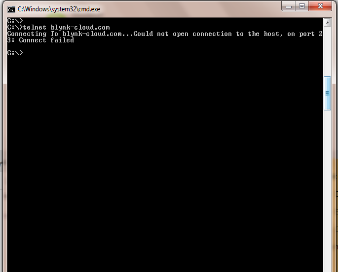

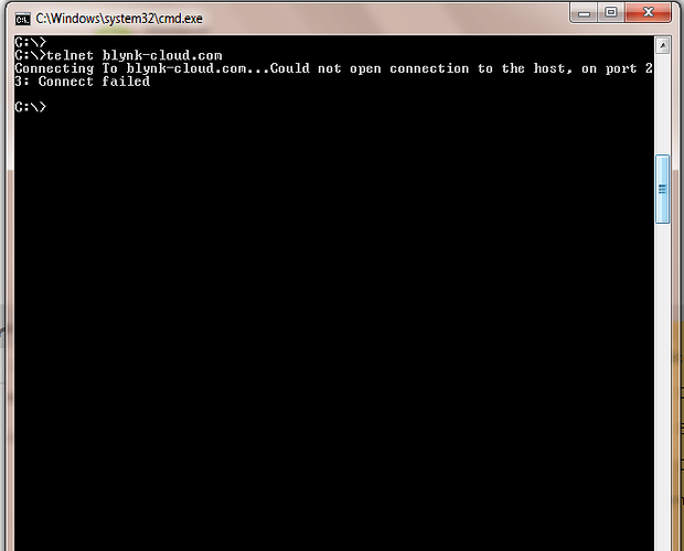

hi Gunner,
i checked with telnet command, and shown as below.
Then try connecting your ESP with the supplied IP instead of blynk-cloud.com
I don’t know… could be port forwarding, could be ISP blocking…
Blyn doesn’t use telnet that I am aware of… just HTTP
Hi Gunner,
Thanks for your advice.
I found the solution, the isp block port 80, so i just need to define the port which are opened and then connect it.
