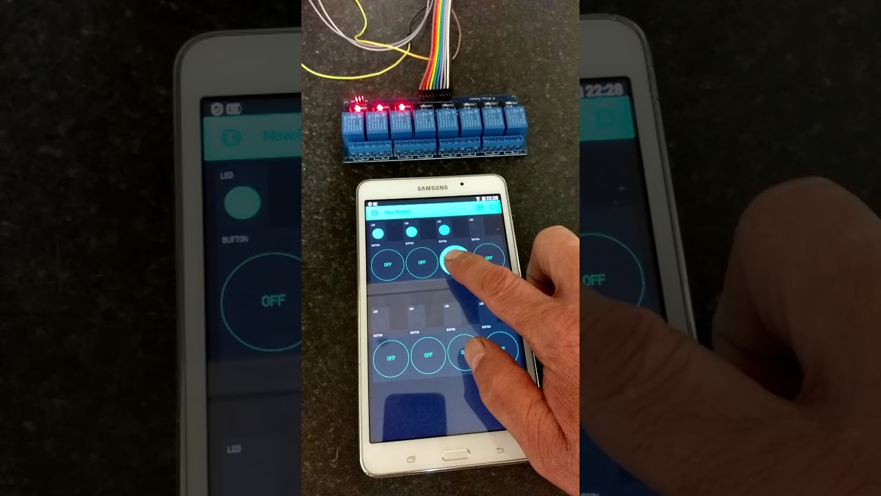

Hell Yeh! … ![]()
I did it! ![]()
Well I sort of did it. ![]()
After reading all the comments in this post I decided to use @dutchman’s code as a base and build off it. My version of it isn’t the best, and it’s a bit laggy but its works. ![]()
