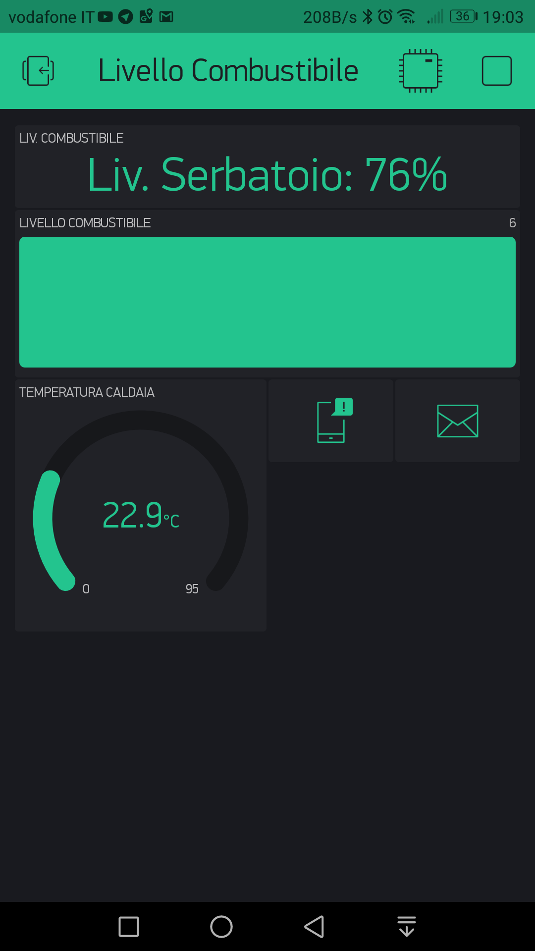

Hi guys give me some help, unfortunately the Label read the sensor value but when it’s full I read 0% and when empty 82% I tried to create this
Blynk.virtualWrite(V0, 82-r); //Virtual Pin Label (82-r per avere il valore invertito)
83/5000
it reads the inverted value but does not make me perceptual between the values
Max 82 and Min 6
int y = map(r, 6, 82, 100, 0); // valori di percentuale Min 6 - Max 82
  Blynk.virtualWrite(V0, y); //Virtual Pin Label
so it seems to be fine
