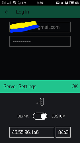

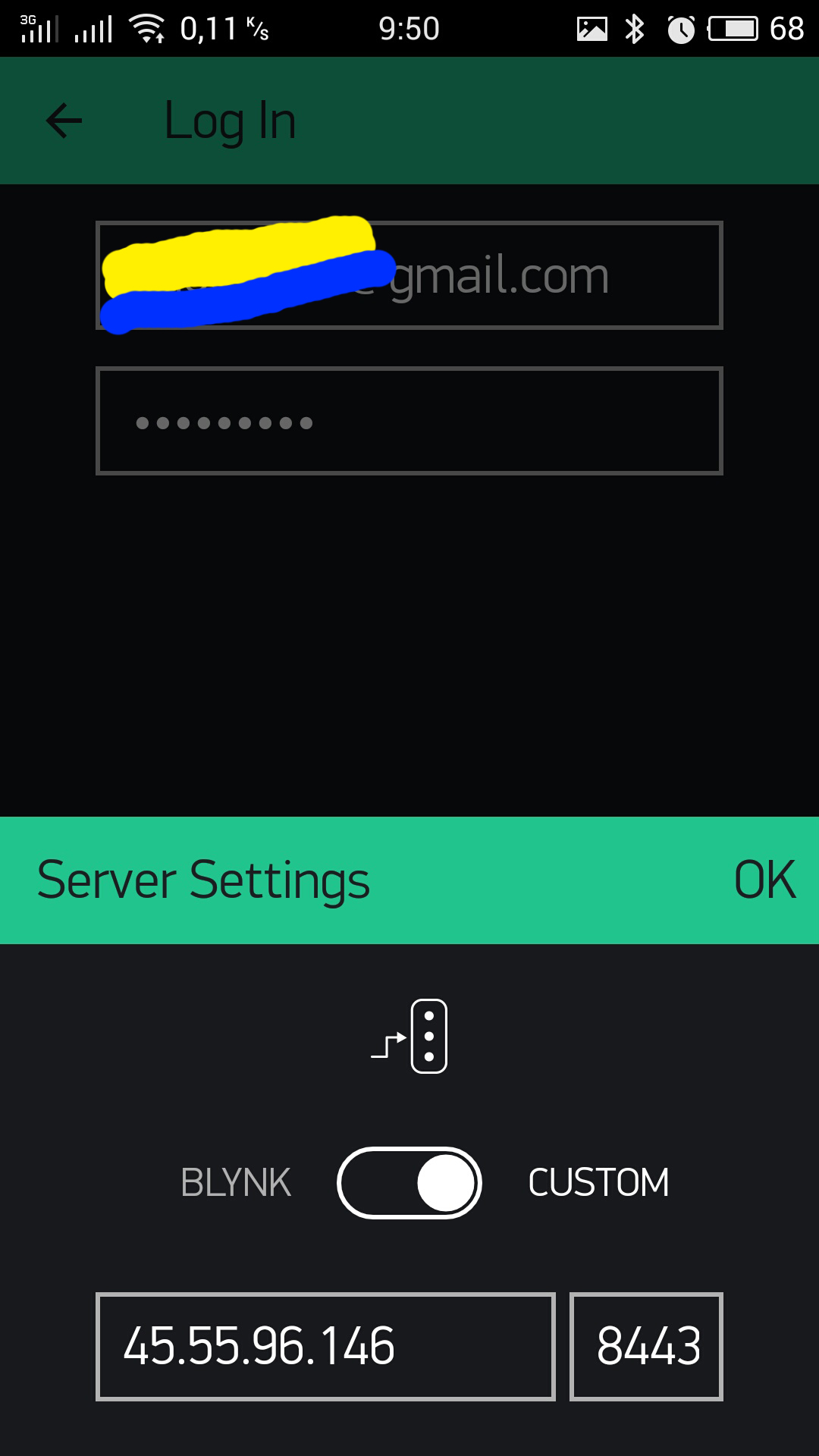

Можливо я щось не розумію, але там вказано ввести ІР локального сервера, а я використовую хмарний сервер.
ping blynk-cloud.com from the network your hardware is connected to. Use the IP address that you get during this ping and put it in mobile app.
I got a ping blynk-cloud.com 44.55.96.146, wrote, log in
but will still not opened a design that I created yesterday. :sob:
Я пінгував blynk-cloud.com отримав 44.55.96.146, написав, увійшов
але всеодно відкрився не той проект що я створював вчора. :sob:

Yeap. As previously you were logged to another server. I may give you other IP if you provide me with your acc.
mail sent in private messages
@Dmitriy Thank you for your help, is working well. :wink:
No problem. We will fix this issue soon.
