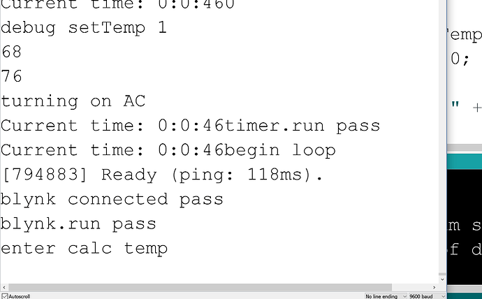

Added yield() inbetween the write functions. I’ve noticed it seems to hang up here:
After my first conversion. It seems to choke right there for a few seconds, then it connects again and continues. However, I have lost control through the app.

So I did two tests:
  1. I removed the void setTemp(); declaration
  2. commented out 3 of the 4 Blynk.virtualWrite() functions.
with #1 I noticed the same hangup as before where the Serial output stalls during calculatedTemp() function and my Blynk app loses the ability to control anything.
with #2 it seems to be working without any delays. Is there a max frequency I can update with a Blynk.virtualWrite() call?
