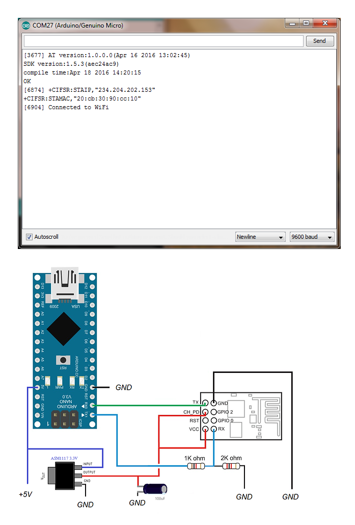

I have spent two day for Arduino Micro + ESP8266 -SP1 + Blynk v3.8. My diagram is the same below one but with Arduino Micro. Finally, i got this result, nothing more.

What arduino are you using? You show a picture of Nano?
I am using Arduino Micro

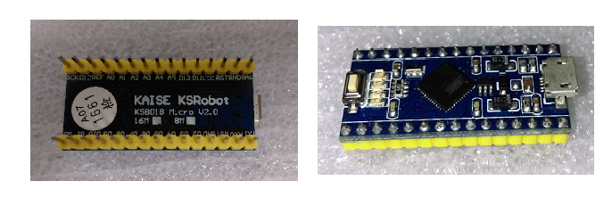

@Lichtsignaal yes they are like Leonardo’s with the USB as a virtual (CDC) com port and then the onboard com port.
I still am looking for other ideas. confirmed again, I am using Arduino Micro + Blynk latest version (v3.8)

From above captured serial monitor, I see that my ESP got an incorrect IP address from DHCP although serial monitor shown “connected to wifi”. It has to be 192.168.0.X as my router. Thus, ESP did not connect exactly to router. After checking AT commands, I revealed that I have to set ESP to client mode and disable it’s DHCP.
Finally, the command helped me having motivation with ESP8266:
AT+CWDHCP=1,1
