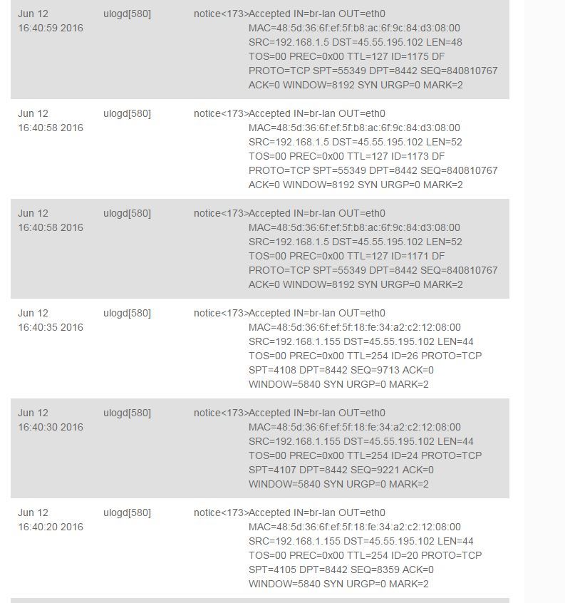

My router logs show both my telnet and the esp8266 packets being accepted.
any suggestions?
Here’s my output from the debug and the router log
