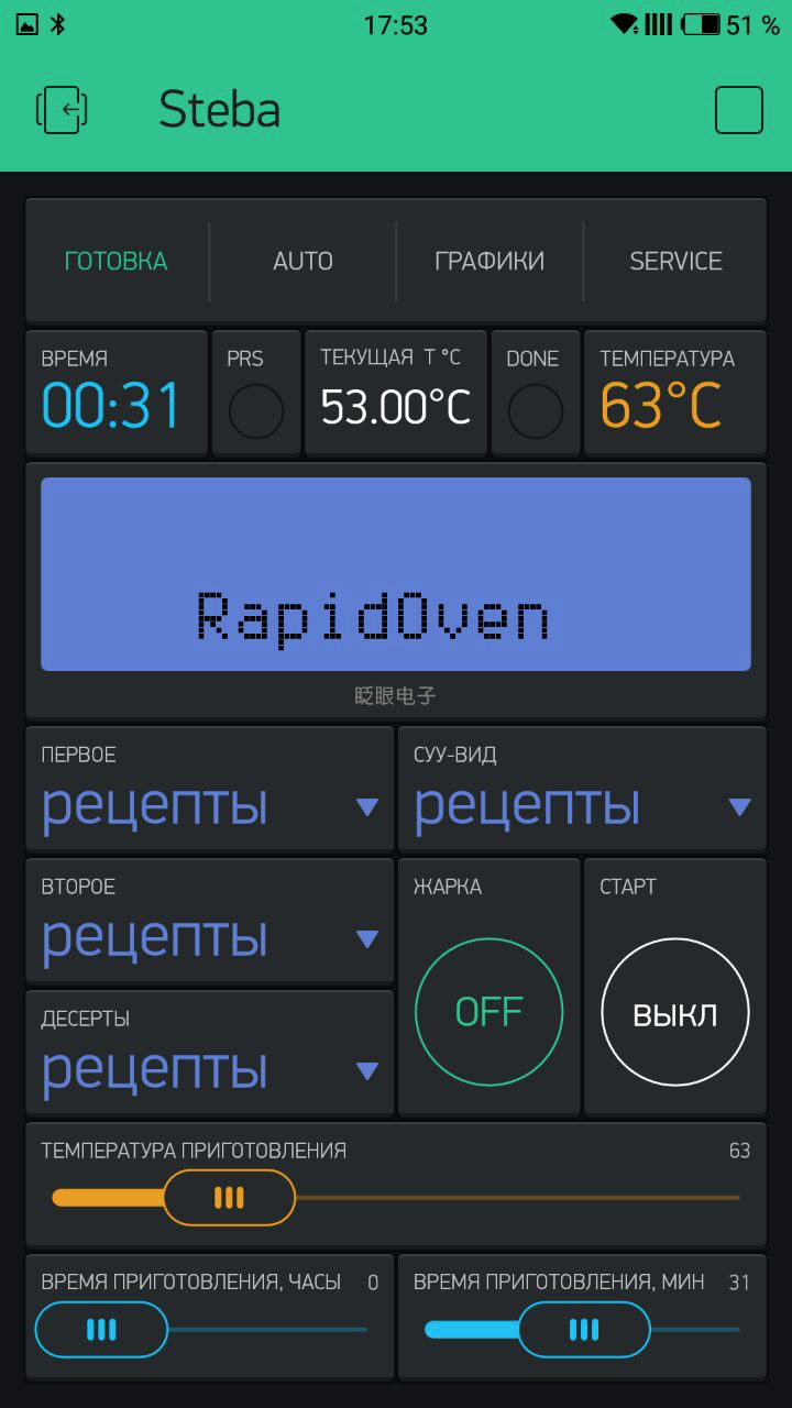

PS
my project. preparing big title about it
